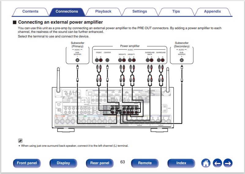

Currently running a 7.2.2 from a Marantz SR6013 and a stereo zone 2 through a Dayton amp to my patio. I just ordered a Marantz MM7025 to power the front towers. Looking through my manual, it seems I can run 2 channels through an external amp or all channels through an external amp. Although I don't see the settings for all channels, a note in the manual states running each channel through an external amp enhances sound quality.
I could wait and figure this out on my own, but I'd like to pull the system away from the wall once. Can I run my patio speakers through the Dayton, my front through the new Marantz amp and everything else from the Marantz 6013 internal amps? Or do I have to ditch the Dayton, run the patio through zone 2 speaker connections vice preamp, and then I can bring in the 7025 amp for the front?
I've attached the page from the manual mentioning an external amp.

Yes, you can connect an external amplifier to each pre-out on your SR6013.
There are no special settings for the use of external amplification except connecting the appropriate pre-out with one of the amplifiers. You will most likely have to manually readjust the speaker levels though for the externally amplified channels. Zone 2 can be used with your Dayton amp for your patio, and the front L & R speakers can be driven with the MM7025.
Marantz says that the realness of the sound can be enhanced with external amplification, but that is inexact in most situations. In your case, you have a stereo amp to drive two of your front channels and another one for patio. The remaining channels can easily be driven with the AVR onboard amps without any struggling.

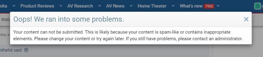

<For some reason this post keeps getting a reject. Says it's spam or inappropriate language. Been trying to post this since yesterday evening shortly after I got the advice. I took out a second paragraph containing a little levity, but no inappropriate language. Seems a little uptight?>

Ok, figured out why the previous post didn't go through yesterday! So as I said, I put a 2nd paragraph with a bit of levity. But ah, it could have been the wrong kind of levity for this forum. I remarked about me stating "It's really sweet now." Which made me question the purchase of an additional amp. Now I realize, this is "Audioholics" and one should never question the purchase of more audio gear! What was I thinking? So sorry.

As to getting the message, I've seen that before.....but more curious the content that triggered it....was it simply the text of what you wrote or did you have an attachment or link?

No attachment or link, just a bit of text lightly ridiculing myself for saying my system sounded sweet, yet I was spending a grand on another amp.

I think there's just a limit imposed for new posters. Not sure what would be rejected but once you reach a certain minimum post count there shouldn't be any more limitations.
