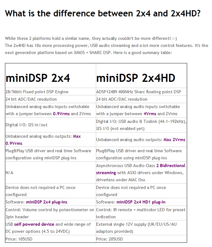

Wow thanks for the specs on the mini dps. hd

I still have my HD, back in the box after spending hours (less than 40 hours I guess) on using it in various ways and plotted tons of graphs. Thinking of letting it go for bo, no warranty as it was purchased in Aug 2017.
