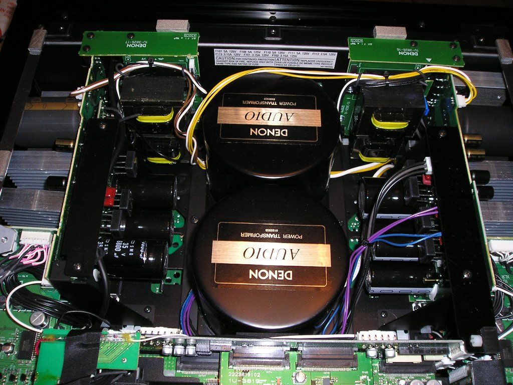

The Denon AVP-A1HDCI preamplifier has 7 power transformers. But only 2 power transformers are MASSIVE TOROIDAL transformers; the other 5 power transformers are just regular size. :D

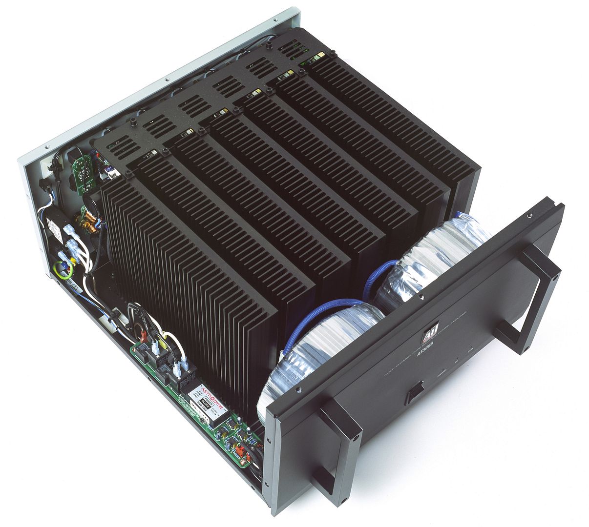

My ATI amps also have 2 MASSIVE TOROIDAL TRANSFORMERS. :D

In addition to electro magnetic shielding, the performance to weight/size ratio also becomes more important in a multi channel amp such as this that adopts the mono block design.
Bypassing the MASSIVE HEAVY EXPENSIVE Toroidal transformers would be my preference if Denon could have gotten the POA-A1HDCI down to 90lbs, instead of 130lbs. :eek:
PENG
Everything else being equal, the toroidals in it had already reduced the weight.

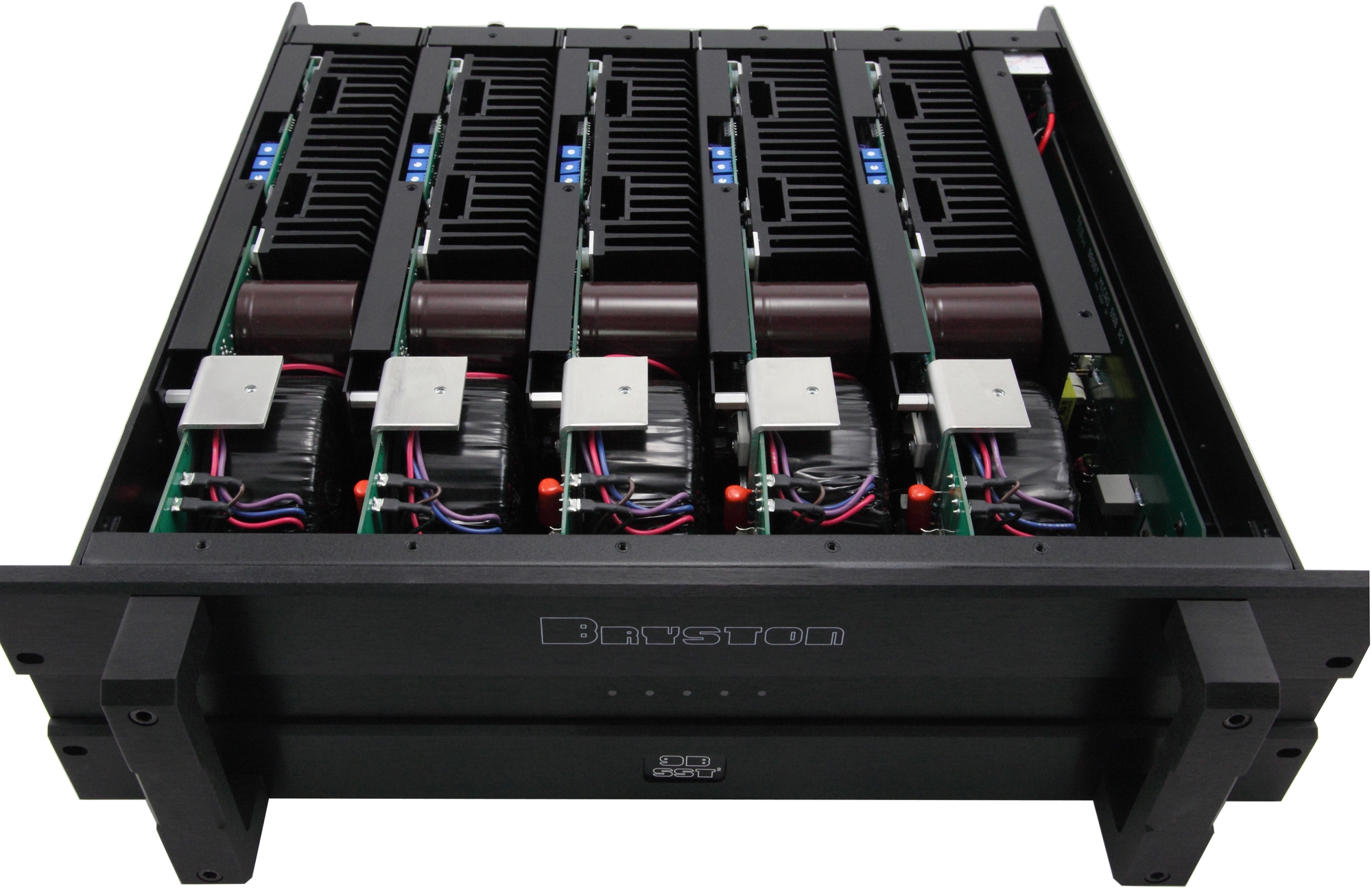

My 4BSST and A21 hum a little louder than all my Denon AVRs that are EI.
I would expect that the size of the transformers in your Bryston and Parasound are larger than what's in your Denon. At least mine are!

Of course they are larger, good point. I also had a bad laptop charger that if plug into the same outlet, would cause major hum in the A21 but not the Denon AVR and Marantz amp, so I would say the A21's power supply is definitely more prone to external interferences. Normally I can only hear the A21's large toroid with ears within an inch to the top, the Bryston is slightly louder, but it has two toroids.
