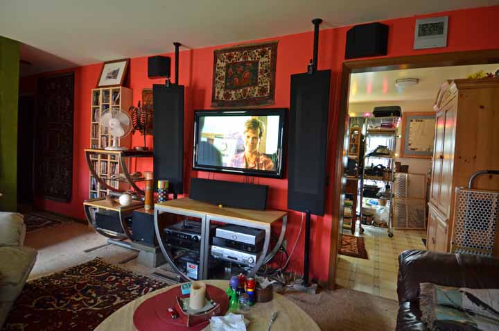

I was determined to use MMG's in my small (11.5' x 17' x 8') living room. I wanted to suspend them off the floor in such a way that if they didn't work, i could send them back to Magnepan in perfect condition. My solution was to use a Bogen/Manfrotto Autopole system i had in my basement photo studio. It turned out to work perfectly, so the Maggies are now part of my HT living room system.

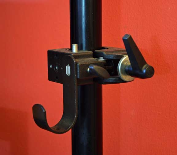

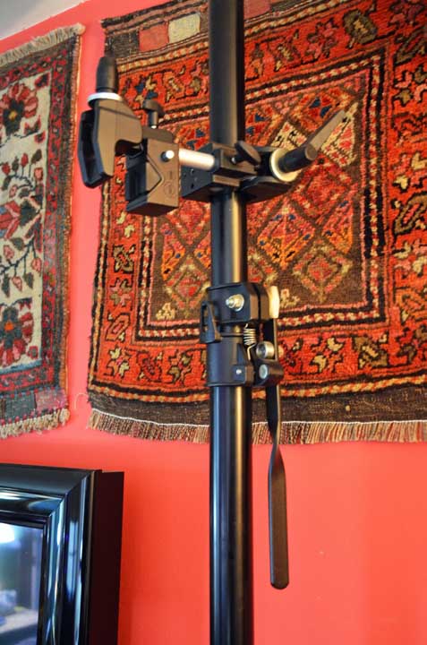

Here's some photos of the Bogen Superclamp attachments i used to position the MMG's away from the wall & angled into my couch listening area.
So i needed 2 Autopoles ($155), 6 Superclamps ($25 ea.), 2, 6" extensions ($16), & 2 J-Hooks ($10) to complete the set-up.

I used some small paver bricks to give them a more solid base than my ugly wall to wall carpeting. The spring loaded design keeps them very secure & at high volume they didn't rattle or shift position. The heavy suction cups at the top will leave marks on your ceiling unless you put paper or something in between. Their are lots of options with the Autopoles including extensions for higher ceilings, bases for a floor support etc.
I know this set-up is kinda pricey but considering my akward room & the price of MMG's, i'm elated with being able to keep them & thought it might help other people who have less than ideal rooms for the smaller Magnepans.

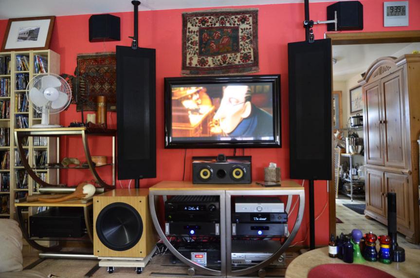

Also, i should add that you could easily suspend a 3rd MMG between the poles for a center channel.

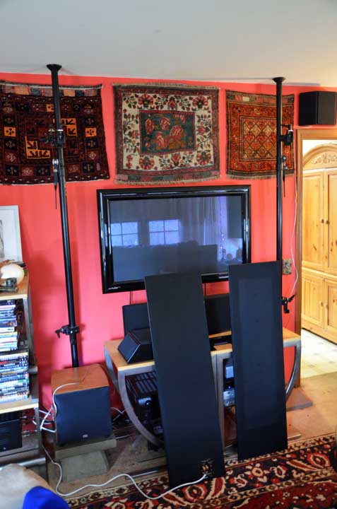

Here's a better photo of the angle from the wall...
Have you tried using them further out into the room? It looks like you have them closer to the back wall than Magnepan recommends.
munroe
If you look at my photos, you can see that i don't have the room to move them further out. But all is fine, they sound wonderful & the soundstage doesn't seem constricted by their asymetrical placment. Yesterday i finally recieved my Rythmik E15 SE-B Subwoofer and so far it's a perfect, seemless match to the MMG's.
