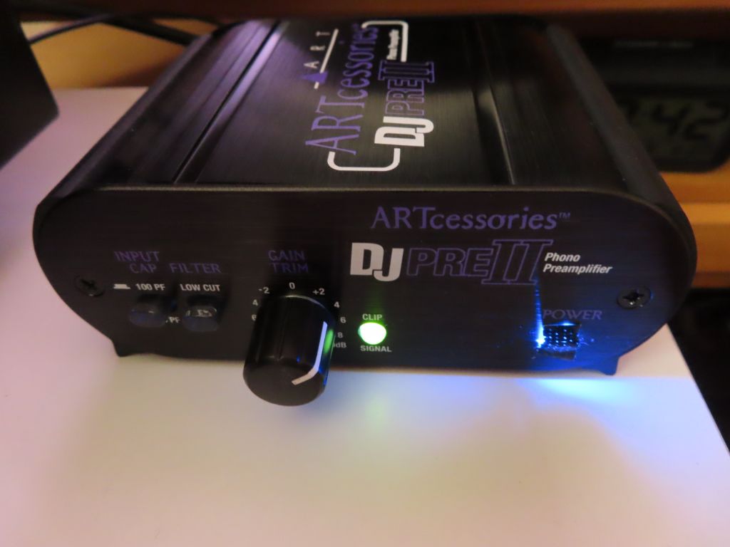

Hey TLS Guy, the Pro-ject Phono box looks like a good solution, so thank you. However, I can't thank you for the insult. Was that really necessary?
Sorry about that, but we do tend to josh each other quite a bit here. Enjoy your turntable!

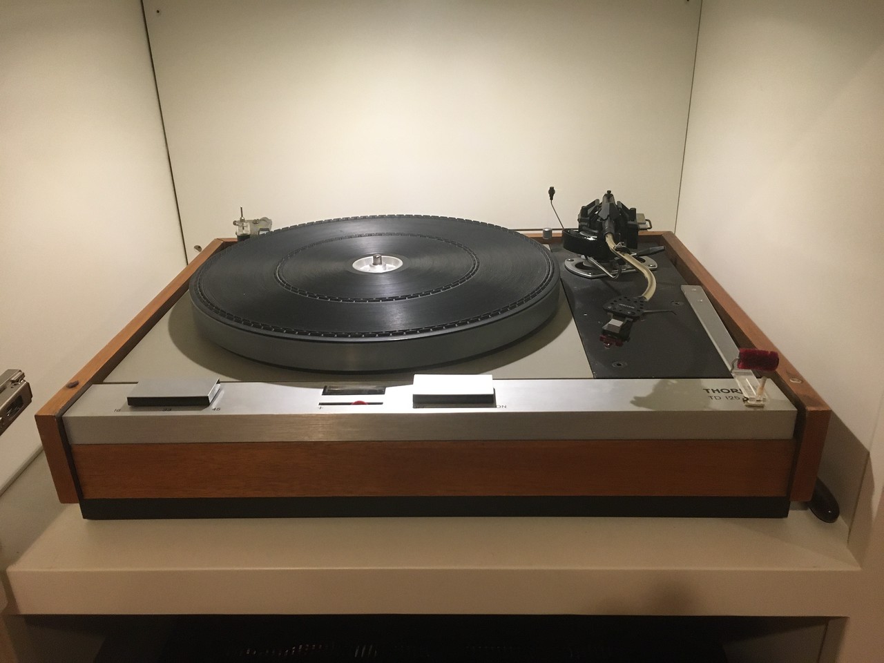

Hello all: I have a Thorens TD160 turntable connected (as directed in the manual) to the TV/CD input on the receiver. My turntable with its original Ortofon OM10 cartridge has been in storage for years but was functional the last time it was used with a Sony stereo receiver.
I resurrected the turntable recently and upon connection to the receiver, the output with max volume is what seems like ~20% of its potential. So I ordered a Fosi Audio P1 tube preamp, thinking that would solve the problem. However, with the preamp turned up all the way, the output from the Onkyo is about the same. I'm kind of stumped as to what's impeding the volume output. Any ideas or suggestions would be appreciated. Thanks!

The Thorens doesn't have that, actually don't remember any tts from that era having its own phono stage....wasn't necessary back then as all the receivers etc would have one built in.
You need to switch on your TT's built-in phono preamp and connect its RCA output to the receivers TV/CD input.
A Thorens TD 160 turntable does not have a built in phono pre/amp. The only electronics are a simple on off switch with a cap RF suppressor across the contacts, a Papst synchronous motor and the wires from the tone arm, connecting to a solder terminal block for the RCA leads. That is it.

Here is the user manual for the Thorens TD 160. This turntable was produced from 1976 to 1984. 1984 was when CDs first hit the market. Interestingly the manual just says to connect the RCA plugs to the amplifier input. It does not specify an RIAA phono input. So back then it was assumed that everyone knew that you had to connect a turntable to an input of high sensitivity with RIAA correction. How times have changed, as back then the writer of the manual did not feel he had to state the obvious.
With the introduction of the CD, turntable sales plummeted and everyone assumed the LP was a dead medium. Thorens went bankrupt. The name was bought by new owners after the LP revival. The current Thorens is not the Thorens of old, that actually goes back longer than the phonograph, as they started as a manufacturer of Swiss musical boxes. They were complex and you could change the cylinders to change the music. I have seen them in museums and they are works of art. I don't think they ever made wax cylinder machines, but they were early manufacturers of acoustical gramophones to play the Emil Berliner discs that became the 78 RPM shellac disc.
They were the principle competitor to Garrard in the 1950s and 1960s. The TD 124 went head to head with the Garrard 301. Here is a picture of a TD 124 with an Ortofon arm.
The last of this illustrious line was the Thorens TD 125 MK II.
That is my Thorens TD 125 MK II that I restored with an SME Series III arm. That combination is about as good as it gets.

to further what Doc was saying I remember a Pioneer Elite AVR I had years ago that did have a phono 'input' but it was without gain, thus the need for a phono-pre ahead of it.
It had just the RIAA eq? I've not heard of that before...
