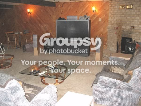

mfabien said:
Yes, you can toe them in such as I have them here :
Nice setup! How far apart are your speakers? What are the benefits of spreading the speakers further apart, and then toeing them in? Does the soundstage get wider?
thanks,
Ohmage.
They are 91 inches apart. For surround sound, the stage is wider.
I learned the advantage of this placement at:
http://www.bilocation.co.uk/settingup.htm
when I purchased the "Bilocation 1" DTS disc. I then realized that this placement is indeed much better for listening to DTS Music disc's or Concert DVDs with DTS surround sound. For instance, I really do enjoy the Eagles and their productions in DTS is very pleasant with my setup and, may I add, my SVS sub (you can barely see the top of the sub over the right armrest of the love seat on the right side of the picture) uses this Front Towers and the Center speaker to make them the apparent source of bass frequencies.
