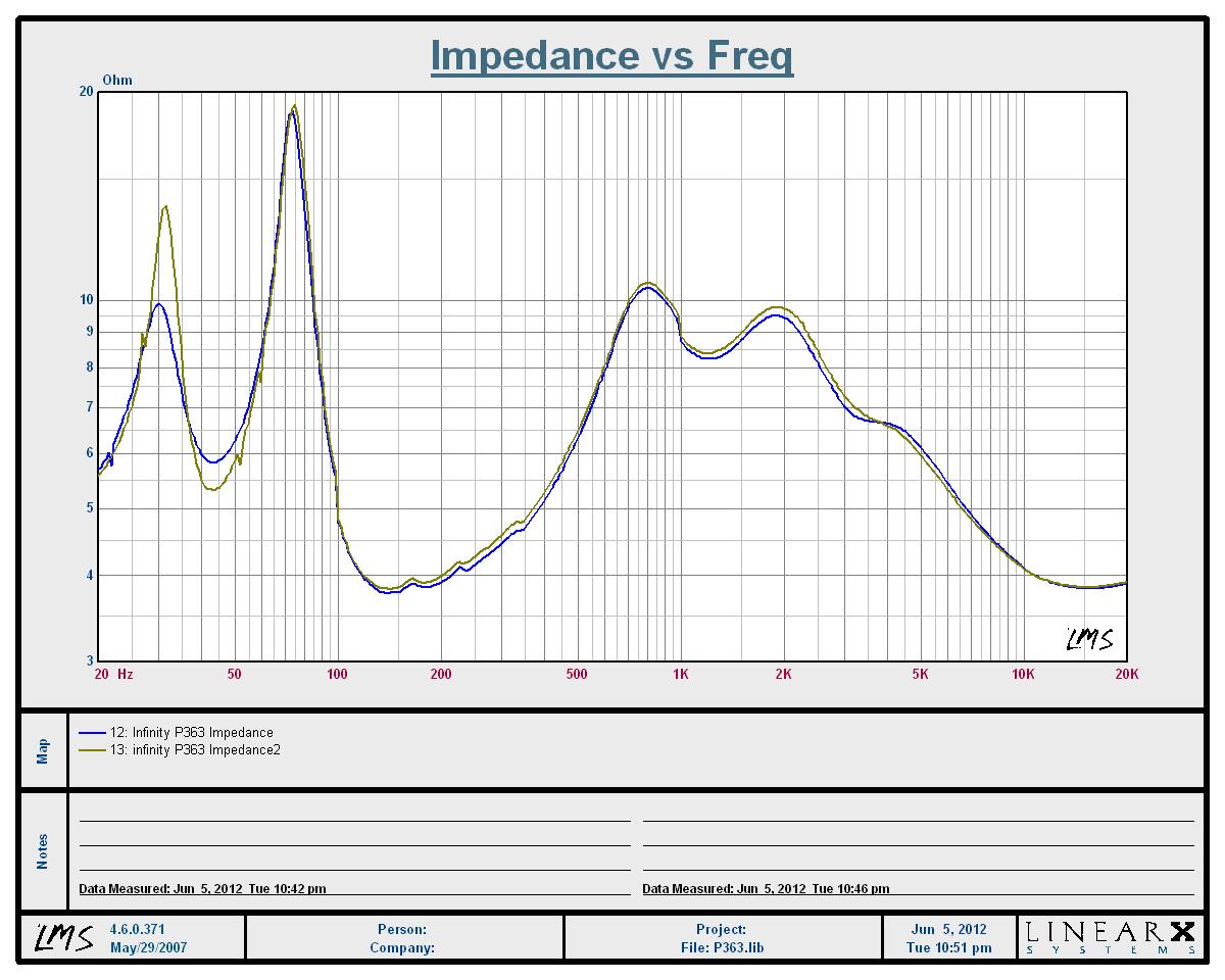

This is NOT rocket science. Data sheets are readily available comparing metrics of various capacitor types showing ESR and DF vs frequency. No legitimately good speaker designer is putting electrolytic caps in series with a tweeter anymore. Those that use electrolytics often bypass them with smaller value NPO caps to achieve better results.
Why would one want to make a less reliable, less precise design simply b/c their limited listening test, testing a limited sample size, on a limited audience may not have produced sonically verifiable results? As an engineer I always designed things to be accurate and consistent, using Monte Carlo analysis to ensure my designs always met min target goals.
Look at the impedance graphs in my Infinity P363 review and note how the 2 speakers don't measure exactly, esp around resonance.
http://www.audioholics.com/tower-speaker-reviews/primus-p363/P63_impedance_compare.JPG/image_view_fullscreen
Simply using better parts and tighter QC for a few bucks more would have solved that. Dumbing down the science to cheapen a product is not a good design choice IMO but I guess that is why there are so many choices on the market.
