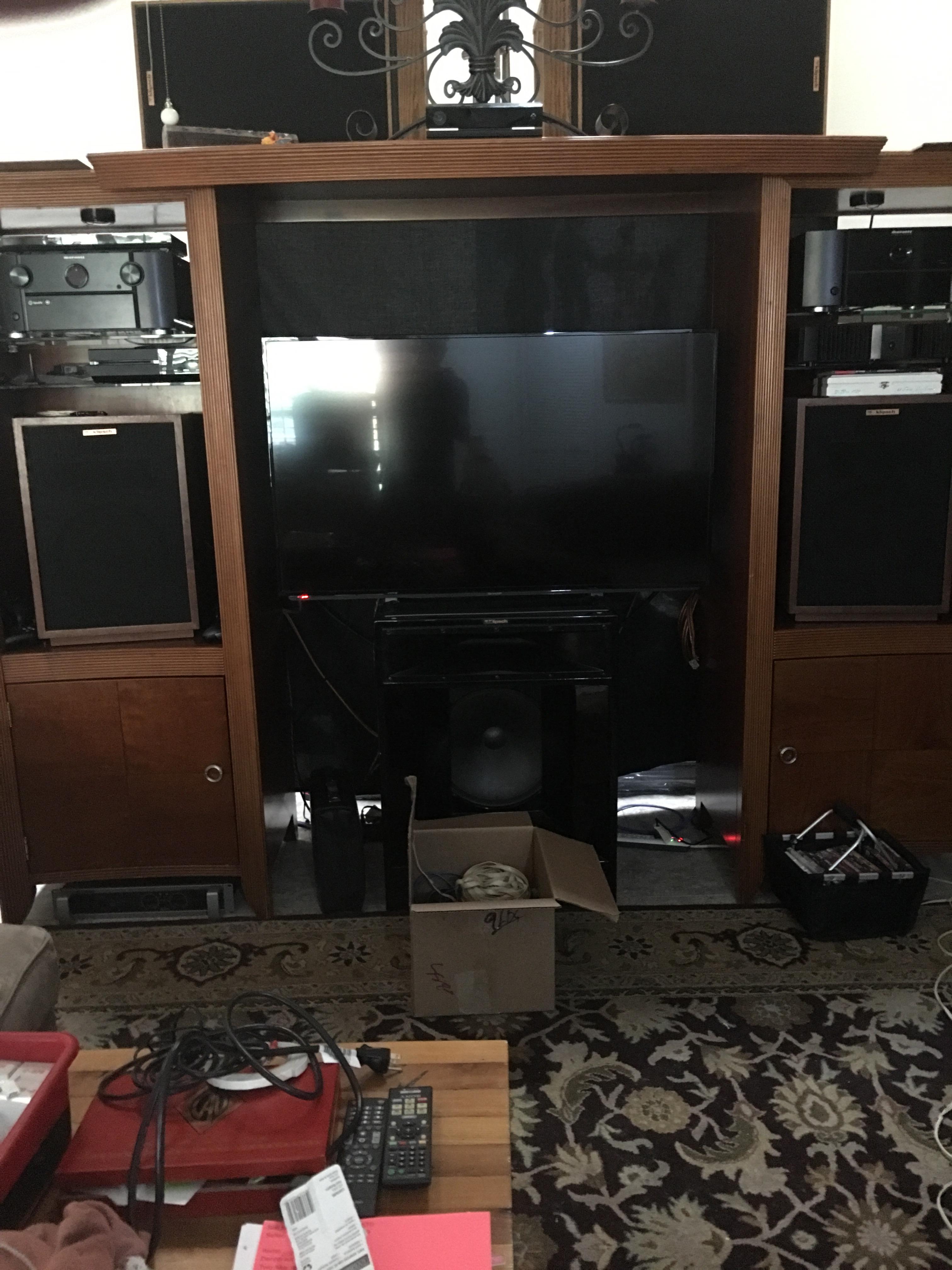

Find a old Yamaha pro two way 15” speaker
I’ve used one for the last 8 years and it keeps up with Cornwall’s and K-horns with little power
In this pic I have my H1’s and I have to turn the Yamaha down to a -10 and the H1’s to a +8 to get the levels close
