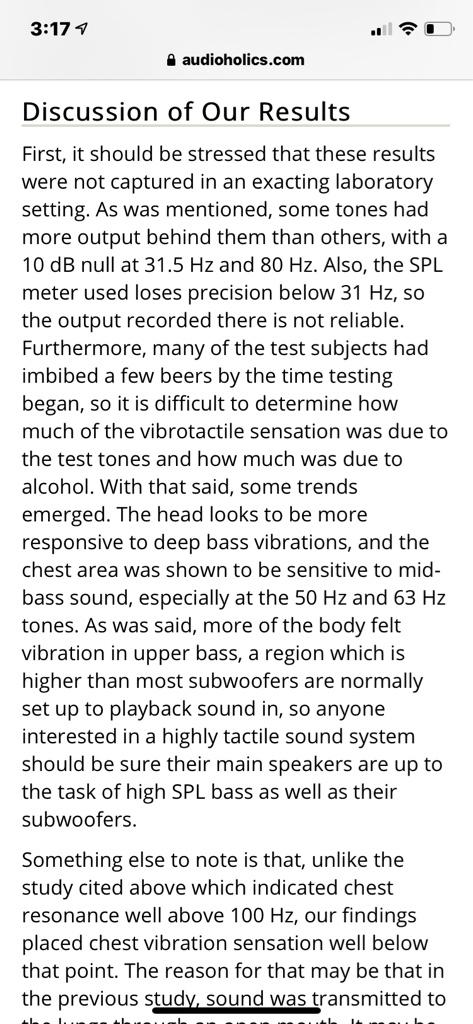

I’ve actually read that one before, and took away the same things(but will read it again) as now. As fully admitted, not all test tone had the same volume, the spl meter was inaccurate and most volunteers had already been drinking. I don’t exactly what the last part means to everyone, but I know once I’ve had a few, going to “11” isn’t enough. Lol. In reading the overview, I feel like it goes with my initial chest punch range of 25-80ish. I’ll read the whole thing just to make sure I’m being objective of course.
From the study...
