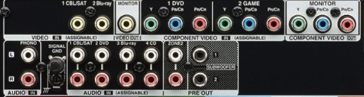

Longtime fan of this site, first time poster. I just bought a Denon AVR-X2500. Music is underwhelming..I am planning on purchasing a new set of Klipsch reference series at the end of the month. The set comes with the r-625fa's (handling 100W cont) for the fronts. I'm currently using Atlantic Technology FS-3200LR-P-GLB speakers.
I still have my NAD 757. I love the sound for music.
My question is, what is my best option? Do I get a seperate amp for the Denon? The attached image shows my "pre-out" options:
Can I use my NAD for the fronts in some way?
I have a few days to return the Denon. Any advice is greatly appreciated. Thank you!

That denon doesnt have pre out. Its just for subwoofer and zone 2/3 not any main channels. Think the denon 3400 is the lowest with pre outs and its a bit more powerful also.
Does the nad have any home theater bypass or such? Edit: Disregard, its an avr so unlikly.

Thanks for confirming my suspicions on that.
