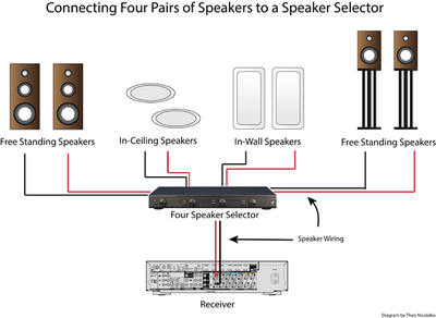

I believe it would be impedance, attached is a diagram from the manual. Am I wrong or not understanding it correctly?
We do not mess with audio, just DDC controls.

You need to look into the way these controls work- in order to maintain impedance that an amp can handle, the input has multiple taps on the winding and when the switch is moved from one position to another, the resistance will change. Again, this is the reason the resistance MUST be measured if you want the amp to survive.
J
JakeDW
applying my meter across red and black on my wire from the amplifier feeding the VC I am looking to read 8Ohms correct and if that is not the case then that switch should be adjusted accordingly? If I see something much higher than 8Ohms obviously that would indicate I have a short or grounded situation.
You won't see the impedance, you'll see the DC resistance. This is often about 80% of the impedance, but if you see anything below 6 Ohms, don't leave it in that position- when A+B is used, the loads are parallel. If you don't know how to calculate parallel loads and/or design a system, learn to do it or hire someone, if you want the system to be reliable.
