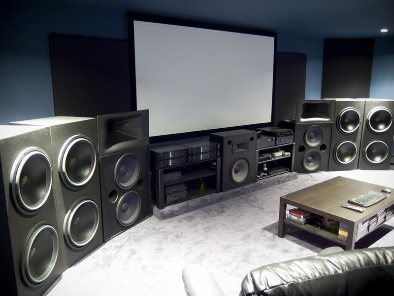

That is a very potent high power in wall system. It sounds excellent and measures very well.
All the parts are still in the C & C machine's computer.
I was wondering if it is something that could work for you. It gives up very little for being in wall. That system is driven by 1000 watts, and fills that very large space.
The transmission line sub makes it unique. I made sure it could be easily duplicated if anybody wanted a state of the art in wall system. Speech clarity is excellent, especially as the mid range driver of the center, covers the whole of the speech discrimination band.
It was designed and built at the request of my wife, who absolutely loved what she calls "her system."

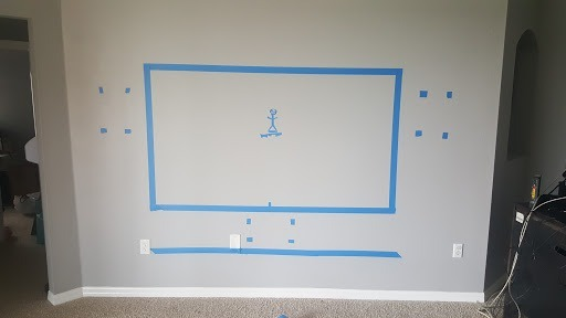

I understand what you are saying. I am not sure if I would want to do a false wall extension like that. If I can, I was hoping to just use in walls off the shelf and run the wires. I just don't know enough about the $ vs performance of current speakers, what vendors are decent and which to stay away from, cone size for the in walls (6 vs 8 inch), etc. Here is what my mock up looked like. The subs i was going to do freestanding in front of the electrical currently on the wall. :

The tweeters on the mains should be 36" above the floor. I just have a concern the mains may be too high on your drawing.

I designed the system I highlighted to exceed anything currently available. The issue that really sets it apart is that TL sub. My wife insisted there be no boxes in the room of any kind. So the sub had to be in wall. That sub even though it is a 10" driver fills that whole space with deep bass at really good spl. I have driven it hard with heavy bass and never had the driver bottom. Audyseey sets it 10 db below the other speakers which measures correctly. So it takes little power.
I think anyone who replicated it would be very happy.
