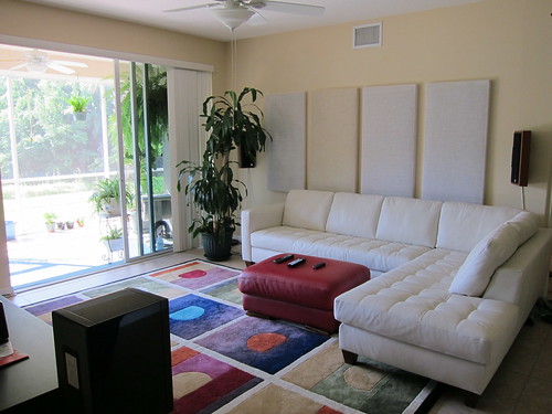

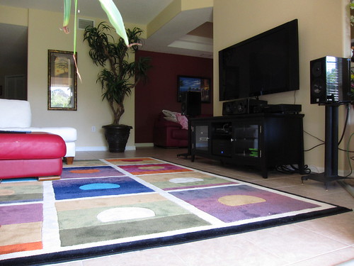

this is what the room looks like
i want to put it next to the tv stand its the only place i can really put a sub .

Good lookin' room.

Since your room is open to other rooms id get the SVS over the ML for sure. SVS subs are very musical & a 12" sealed from them will fill your space nicely!!
To me it looks like you could place a second sub next to the arm of the couch in the back corner by the tree? If thats the case then once you do get a sub, place it on the couch, play some bass tones & walk around listening to the bass up front by your Viennas & back by the tree. Place it in the best sounding spot. If both sound strong & clean then save for a second sub & you'll have very powerful & flat bass in a larger seating area!
