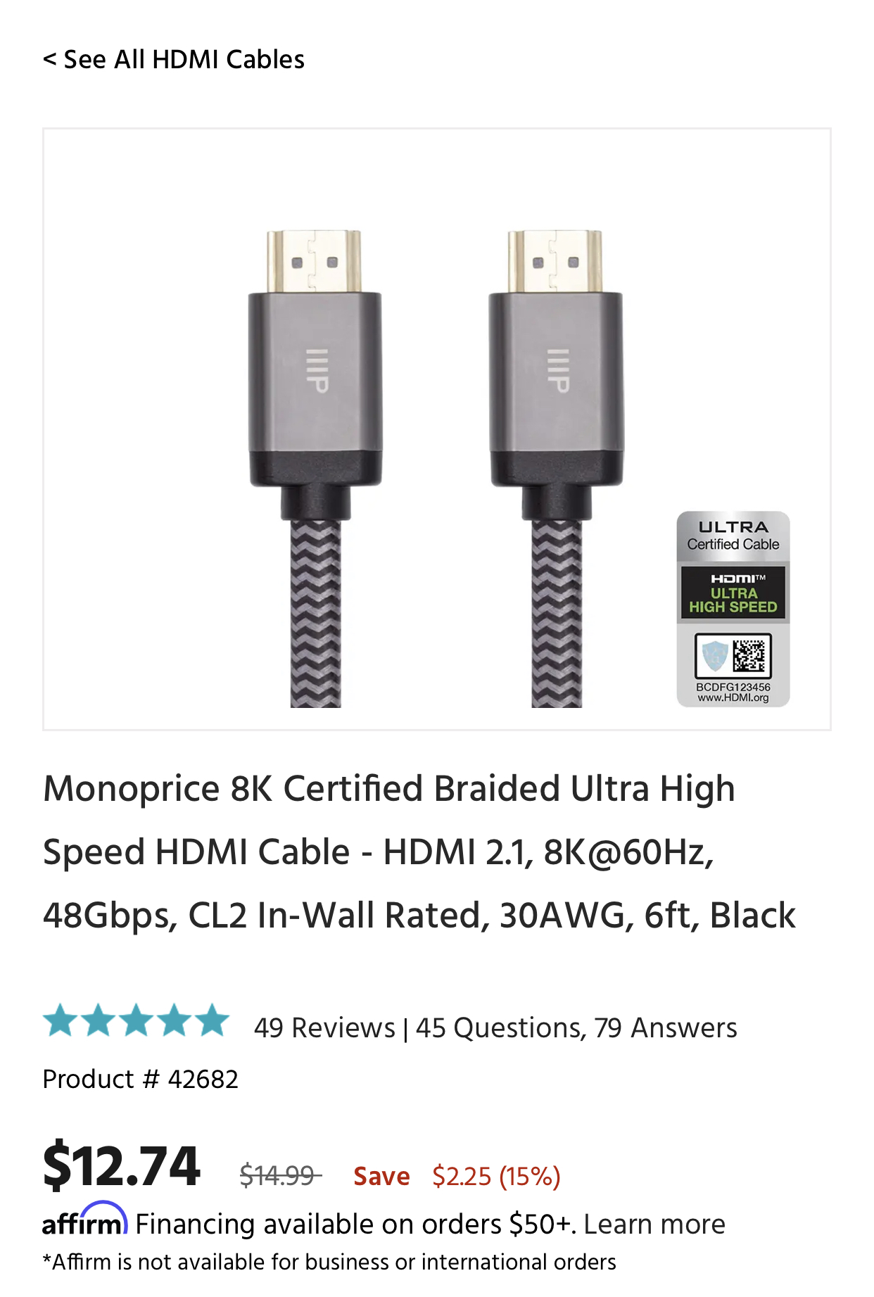

Would replacing these with something like https://www.monoprice.com/product?p_id=31230 make a difference for 4k content?

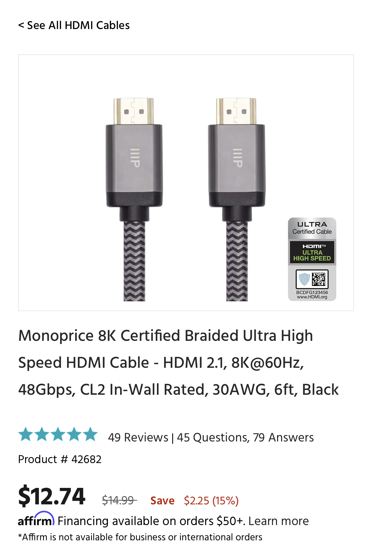

To be honest, I'm not fond of Audioquest cables. So before you return that unit, I think it would be worth trying an HDMI 2.1 cable from a reliable source. I'm not over optimistic about the success of this, but it is following the rule of "leaving no stone unturned." If that fails I would definitely drop that receiver like a "hot potato", and return it ASAP.
What is particularly reliable about the LamToon brand? (altho wouldn't dispute just as good as fraudioquest) Cables aren't referred to by the hdmi hardware designations (like 2.1). Look for hdmi certified speed....

Leave no stone unturned for sure. The specs are suspect on the Audioquest cable. No certification or eARC spec, though their wording is clever. Try these.

Thanks for the suggestions, all. The issue is - I have until Thursday EOD to return this unit. Ordering Monoprice cables will take 3-6 days. Is there a comparable cable that would work that I could order from place with faster shipping (like Amazon Prime - 2 day)? Ultra High Speed Certification, ethernet capable and... what other specs would make a reliable cable?
Trebdp83
Wouldn’t chance missing return window. Return it, try new one with current cables. If problem persists, get new cables.
That is why I chose an Amazon source for you. The cable I linked is reliable at a fair price.

I will be ordering some, returnable, Ultra Hi Speed certified 48 gbps cables from Amazon which will be here in a couple days. If these don't resolve the issue I'll be going the return route.

So, the cables didn't have an impact. I returned the receiver. I'll soon be looking into other AVRs. Thanks again for the troubleshooting help.
