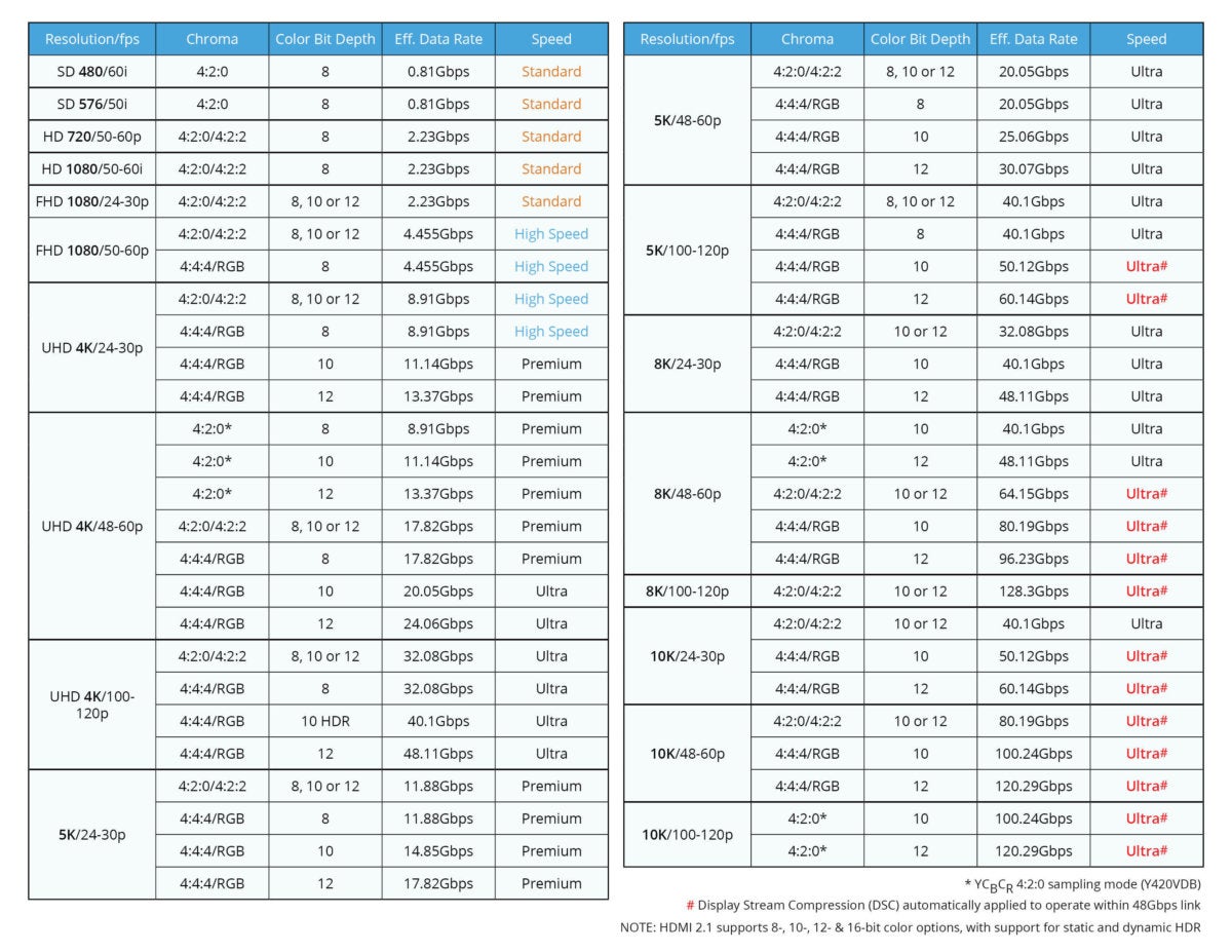

Here's a nifty chart that shows resolutions and the bandwidth they take up...

Thanks! Sweet chart too, very interesting.

That chart should be included in HDMI cable packaging and in the manual of every device with HDMI ports.
