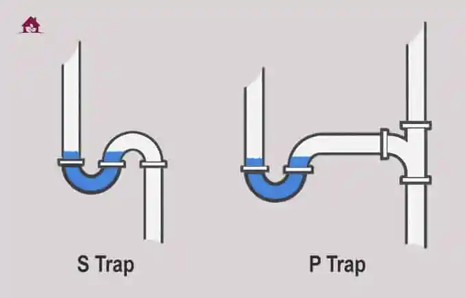

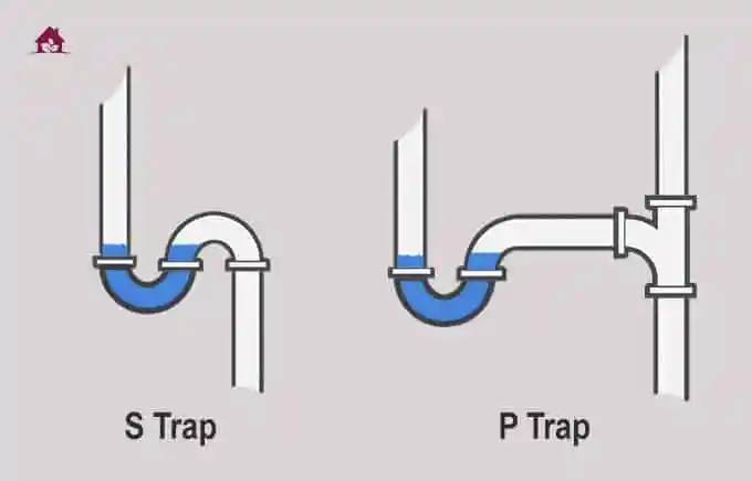

I used the term U-trap only in the generic sense that I had learned decades ago. What I now have are PVC P-traps, as shown on the right side of the diagram below. My house was built to code in 1993. All the drain pipes are PVC and all the supply pipes are ¾" copper. (I'm not sure what the difference is between a P-trap and a J-trap.)

I think he might have meant S-trap which is not legal as best I know, the trap water can run out and allow methane into the house.

J and P are basically the same, just different orientation (P trap is rotated 90 degrees, so the long section is horizontal)- not sure why your graphic shows what looks like a joint in three places, but the traps I see don't have one where the long vertical section transitions to the curve.
