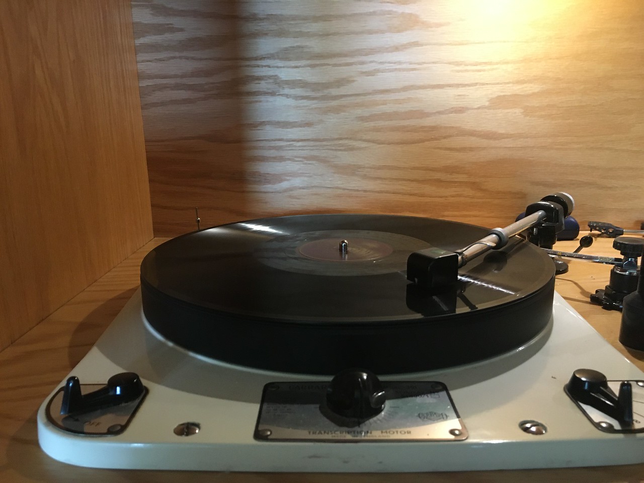

Us older members grew out of tubes like we grew out of short pants. I will admit I do using one vintage tube preamp, a Quad 22, I bought in 1966. The reason I use it as the preamp for my historic Deeca/Garrard rig, as it contains all the EQ curves for pretty much all known 78 RPM discs.
LP
I certainly don't leave it on all the time. The unit does now have DC to the heaters, rather than the original AC. I don't have it there to convince myself it is superior to solid state gear, although it sounds very good, but it is part of the museum end of my collection, where tube gear belongs.
