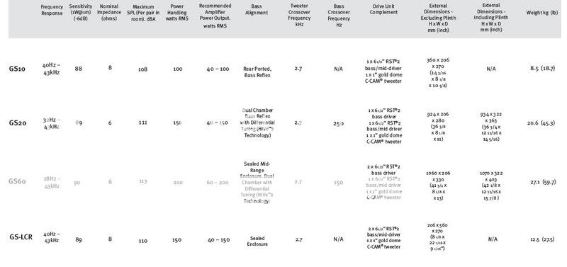

I'm a little confused. The Monitor Audio brochure, from their USA web site, says that the GS-LCR is a 2-way (crossover at 2.7 kHz) and the GS20 tower is a 2.5-way (crossovers at 250 Hz and 2.7 kHz).
Are these same models available to you, or are they different?
they are the same... what is puzzling me is

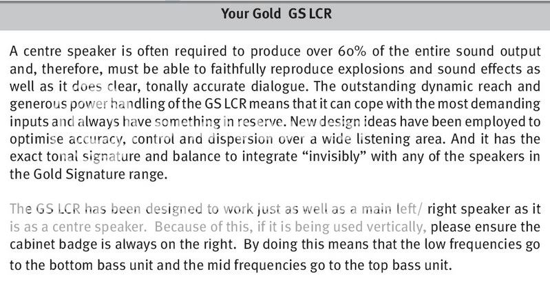

http://www.monitoraudiousa.com/cms/uploads/userfiles/File/manual/Current Manuals/Gold Sig Manuals/GS Product Manuals/Gold Sig Manual CC,FX Rev2.pdf
the gs-lcr manual PAGE 5, second paragraph mentions what I said in the first post re: "low frequencies" going to the bottom driver, and "mid frequencies" going to the top driver. now without a crossover, how does that happen? gravity? :D
mike c
mike c
save you guys the trouble of downloading that manual
let me just post a pic from the manual ... last sentence

The GS brochure suggests the LCR is a 2-way MTM speaker where both midwoofers are getting the same signal. The GS-LCR manual says the two woofers are not getting the same signal, but it doesn't come right out and say it is a 2.5-way speaker like the GS20 tower. Ask Monitor Audio to explain that better.
Another thing you might consider is that the GS10 bookshelf is in a ported bass reflex cabinet and the GS-LCR is in a small sealed cabinet. The bass from the GS10 might do as well or even better than the sealed LCR.

The GS-LCR is a 2.5 way the Bass Driver crossing over at approximately
500Hz

Well OK then, GS-LCR really is a 2.5-way speaker. Monitor Audio should correct its brochure.
