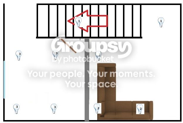

Hmm . . . not sure how to get a Google doc shareable then. It's set to public, but I probably have a setting wrong somewhere.
Thanks for the perspective josten. I don't plan on being in this house forever, so am somewhat loathe to install permanent fixtures. I mainly want an area better than what I have right now (which is about 10' x 12' and forces me to have the direct-fire surrounds in *front* of my listening position), and am okay with it not being 100% ideal. Out of curiosity, do you have a link to examples of DIY in-wall speaker enclosures? That could be a great option due to the screen/TV being right where you walk in.

For that lighting scheme to work, you will need spotlights/recesses lights that can be swiveled and angled.

As far as lighting goes.. Put a lot more than you think you'll need and put dimmers on everything. I have 24 hard-wired fixtures in the 550 square foot common area in my basement and I can dial up any mood I want. They're relatively cheap and like horsepower , you can never have too much:)

Side note - I plan on doing a suspended ceiling with recessed lighting, so that will at least make any lighting mistakes non-permanent. Are there any light fixtures you would recommend I look at mcddmac?

Get remodel cans for the suspended ceiling for all flush-mounted stuff (7.00 a pop) they snap in and the Halos have push-in wire connections. Mono points that attach to ceiling boxes for any projector lights or track- type fixtures ( super easy to change the fixture type)
