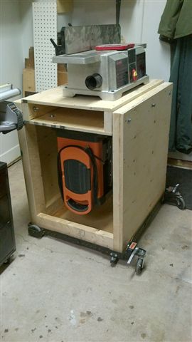

I recently built this stand for my planer and benchtop jointer in order to free up some workshop space. I inserted a 5/8" steel rod as an axle and at each corner is a 3/8" bolt and wingnut. When I need to change over machines, I just remove the bolts, flip the top over and re-install the bolts. This isn't an audio project, but just a change of scenery for the DIY forum.

That's a great idea. I've seen other projects that have done something like that before. One of the one's I've seen uses simple latches at the edge to make it even a little easier and quicker to spin around.

You're probably right, that latches could make it easier and faster to flip. But, these machines aren't light. The jointer is all cast-iron construction and quite heavy. It's compact size might be a bit misleading. So, I used the bolts to help support the weight and to help with rigidity. With lighter equipment, latches would definitely be more user-friendly. But, that's not something I would risk with this one.

Good use of space and mobile is a great way to not lock yourself into one configuration for the shop.
Wow! A thread from the dead! Yes, the stand sure is handy.
My table saw, jointer and band saw are on mobile bases because they're in the garage and I need to park there. The jointer and band saw aren't very big, so they're not a problem but the saw has 7' rails and is 3-1/2' deep, so it takes up a lot of floor space.
