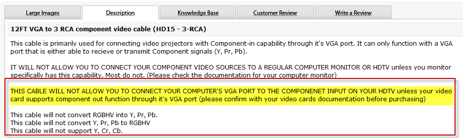

I was wondering would these two cables work for my receiver http://www.monoprice.com/products/product.asp?c_id=102&cp_id=10218&cs_id=1021804&p_id=5599&seq=1&format=2 for the audio and http://www.monoprice.com/products/product.asp?c_id=102&cp_id=10235&cs_id=1023503&p_id=2173&seq=1&format=2 for the video. Would those cables work with my Pioneer 5.1-Channel A/V Receiver VSX-819H-K? I just want to make sure so i don't end up buying unnecessary cables. Oh and once my receiver is connected to my tv am i able to watch movies with my sound system on?

You need this VGA cable.
If you get all this you will have a 5.1 setup from your laptop to your TV.
*** You will not be able to switch your laptop video through the receiver. It isn't going to happen.

I see, the link to the VGA cable isnt working atm but any VGA cable to connect the laptop to the tv for video i assume? and the audio plugs into the receiver.
