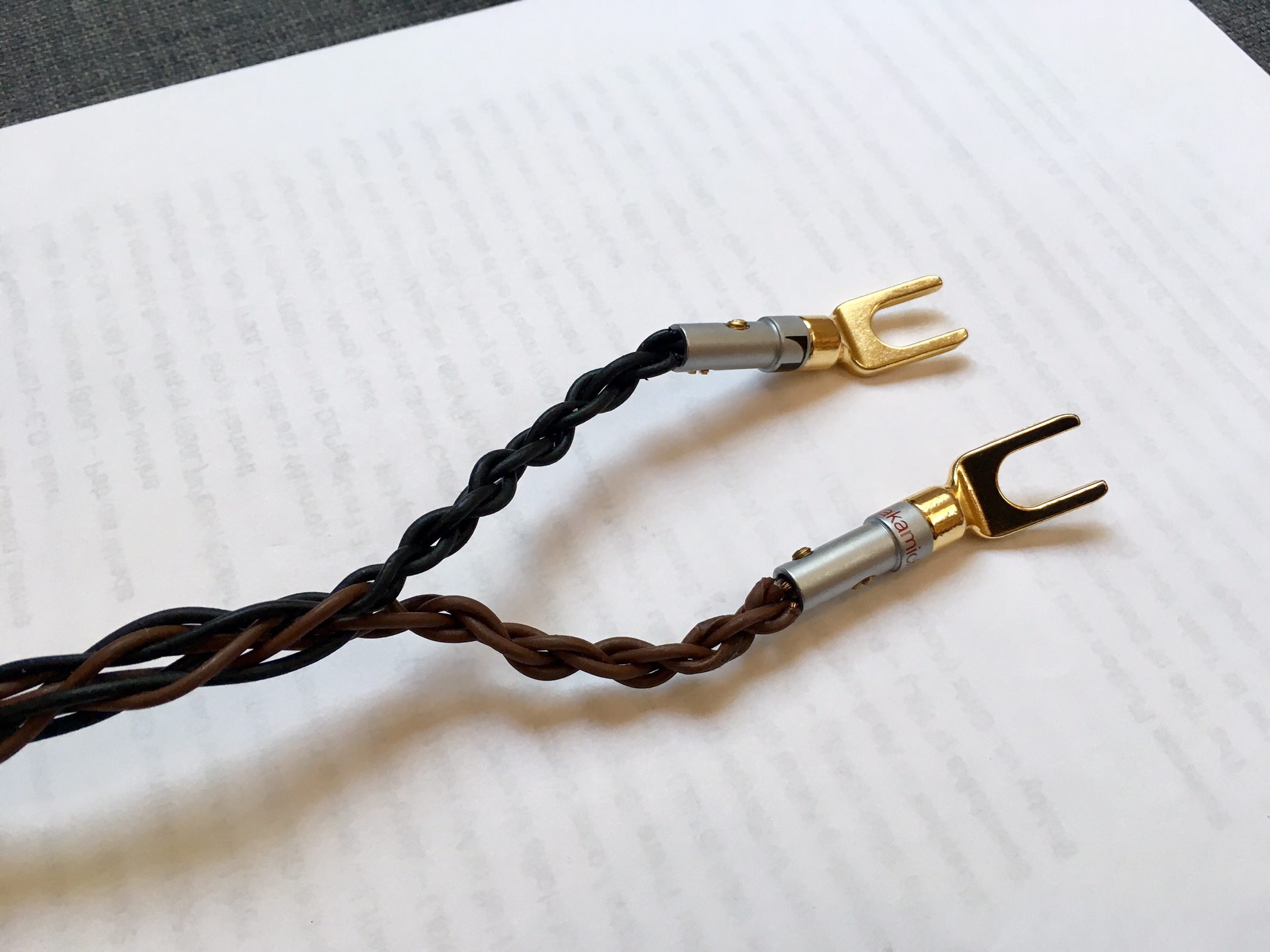

Knukoncepts krux speaker wire ?

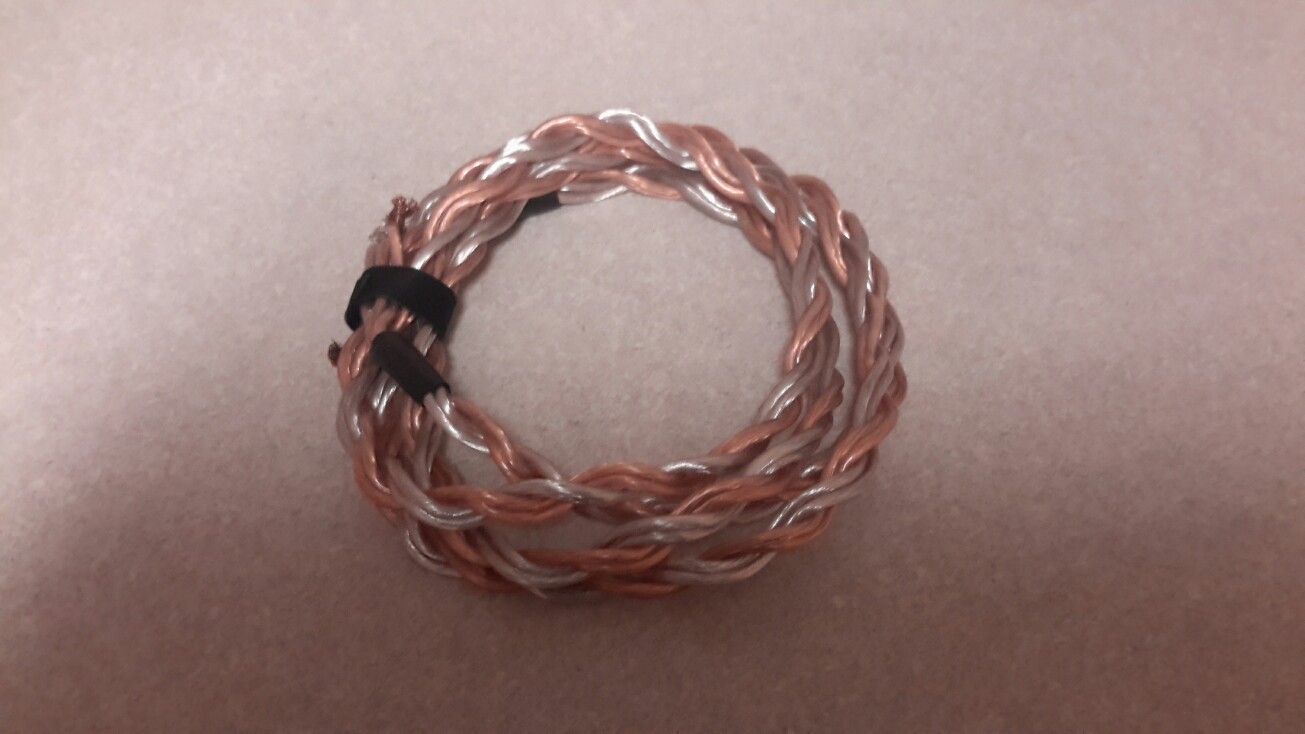

I made this with my own two hands and a drill.
It is made with blue jeans Belden wire with the outer grey jacket removed. Two conductors are twisted together (they already are but it's a tighter twist here) using the drill. Repeat with second pair. Then twist those two twisted pairs together -- in the opposite direction. This creates a double twisted pair. Good For RF and resistance. Two locking spade terminations for amp/wall outlet end, for for the speakers binding posts, eliminating the need for jumpers (aka, bi wired).
This is a short test run for speakers attached to a wall jack.

Those are the cables? They don't look like anything fancy...

Home brewed. I Added a description to photo. Would be Cheaper than knutz. And made of FOUR 10AWG CONDUCTORS.

I see. I did something similar before I learned that passive bi amping was pretty much useless. I still have a couple of lengths.

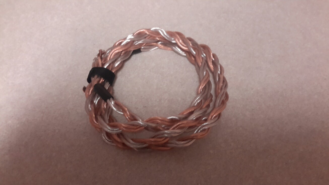

Here is a Kimber 4PR.
See, hot braiding and twisting action!
As you can see, it's not a double twisted pair; instead the eight conductors are woven/braided. Except at the very end where I terminated them, with the pos and neg into double twisted pairs. FWIW, kimber terminates them by just spiraling the four conductors together and putting obscenely branded and redundantly color coded heat shrink on them. Lame!
Something like this is what I'm talking about doing with the knutz cable, but with four terminals at the speaker end at least. No heat shrink. No rubber boots. Maybe just a properly crimped spade for ultra minimalism. Knutz has 16 strands with 4 different colors so one can do it right

I'll bet you mine are indistinguishable from those, tho I might have fewer twists than the kimber... I'm sure they'd say the number of twists in mine are gonna mess up the dielectric blah blah blah. I have a ringer tho. Home Depot. 14awg. Good stuff, and might actually be cheaper to make than the materials kimber and their ilk uses. Not sure about that one though, but I'll bet they pay pennies for their $30,000 supercables.

this whole thread began with a simple question about any experiences with a particular wire and for those of a scientific mien if there might be red flags for it's capacatence due to its braided geo. Because there were aesthetic reasons it was of interest. That's IT.
