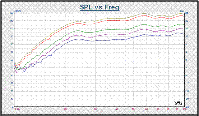

Based on the SPL vs Freq graph, It appears to me that the KL-650 speaker is +/-4dB from 80Hz - 20kHz (the same thing between 200Hz-10kHz)?

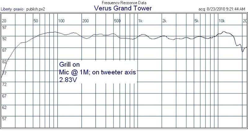

I compared this to the 2010 Speaker of the year Aperion Verus Tower:
http://www.audioholics.com/reviews/speakers/floorstanding/verus-grand/Verus_Tower_meas_AP001.jpg/image_view_fullscreen
I wish the KL-650 graph was zoomed in like the Verus graph to make it easier to compare, but the Verus looks pretty stable at +/- 1.5dB from 200Hz to 10kHz.. How much of an impact would this make sound wise when you compare the two speakers at those frequencies? What should I listen for to hear the difference?
edit: Also wondering why you chose 200Hz as the starting point? From 200Hz to 5kHz the graphs seem pretty similar.. I think most of the +/-4dB fluctuation occurs at 5kHz to 10kHz? (I do agree though that the Verus is handling that section better than the KL-120)
It also does look like the Verus are more stable down to 40Hz like the review mentions. But would this matter if I don't run them large/full range?
I have my Dual KW-120 Subs to take over under 80Hz

...the Verus looks pretty stable at +/- 1.5dB from 200Hz to 10kHz...Also wondering why you chose 200Hz as the starting point? From 200Hz to 5kHz the graphs seem pretty similar.. I think most of the +/-4dB fluctuation occurs at 5kHz to 10kHz?
Yeah, I concur that the Aperion Versus is +/- 1.5dB from 200Hz - 10kHz, which is pretty awesome.
But I think the KL-650 is close to +/- 4dB from 200Hz-10kHz, which I think is not as awesome.
Home Theater Magazine chose the 200Hz-10kHz on their 5-point average FR, so I just went along.:D
Not a fan boy trying to defend my speakers or anything (I actually was considering Definitive Tech BP7001SC in the past). Just wondering what your thoughts were regarding:
1) My previous comment that most of the +/- 4dB is in the 5kHz to 10Khz range. Do you agree that 200Hz to 5kHz seems pretty stable/similar to Verus? (Because you repeated your comment of 200Hz to 10kHz above)
2) What kind of things should I listen for in that range of frequencies (5kHz to 10Khz)?
3) My previous question regarding the KL-650's drop below 80Hz: Would it matter since I have the KW-120 Dual Subs picking up from there? I don't believe these KL-120 speakers are meant to be full range.
4) http://www.hometheater.com/content/klipsch-thx-ultra2-speaker-system-ht-labs-measures Is this the home theater review you're talking about? Because the 5-10kHz measures don't seem as bad here.. is it because of smoothing or is this review not as reliable vs. audioholics testing? How bad is interobserver measurement differences when testing at the 5-10kHz frequency?
Quote from Home Theater website: "The KL-650-THX's listening-window response (a five-point average of axial and +/–15-degree horizontal and vertical responses) measures +1.00/–0.87 dB from 200 Hz to 10 kHz. An average of axial and +/–15-degree horizontal responses measures +1.53/–0.56 dB from 200 Hz to 10 kHz. The –3dB point is at 56 Hz, and the –6dB point is at 49 Hz. Impedance reaches a minimum of 4.15 ohms at 174 Hz and a phase angle of –59.88 degrees at 96 Hz."
Thanks for the help!
I take it ALL BACK.:eek:
Now that is AWESOME measurement!!!:D
I didn't realize HTM also measured these speakers.
But, yeah, I would be PROUD to own speakers with that kind of measurements!:D
Everyone measures differently and every room measures differently; that is why it is ideal to measure in an anechoic chamber, instead of someone's room.:D
The bottom line is, if these speakers sound awesome to you, I believe you.
...I wish the KL-650 graph was zoomed in like the Verus graph to make it easier to compare, but the Verus looks pretty stable at +/- 1.5dB from 200Hz to 10kHz.. How much of an impact would this make sound wise when you compare the two speakers at those frequencies? What should I listen for to hear the difference?
I'm pretty new to reading these graphs so any help would be appreciated =)
Well, a 2.5dB spl difference in that mid band is a pretty significant differences and is audible or should be.
