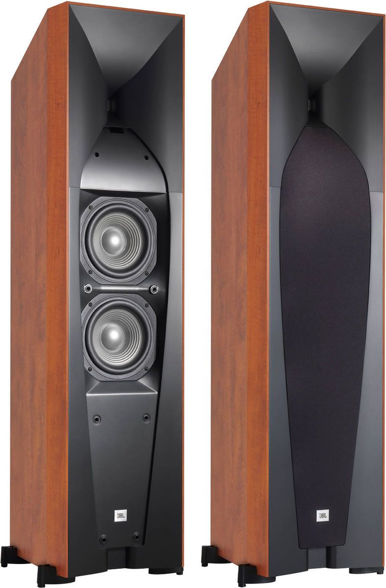

IMHO, the JBL is a beautiful speaker with the grill in place, but rather utilitarian looking without the grill:
