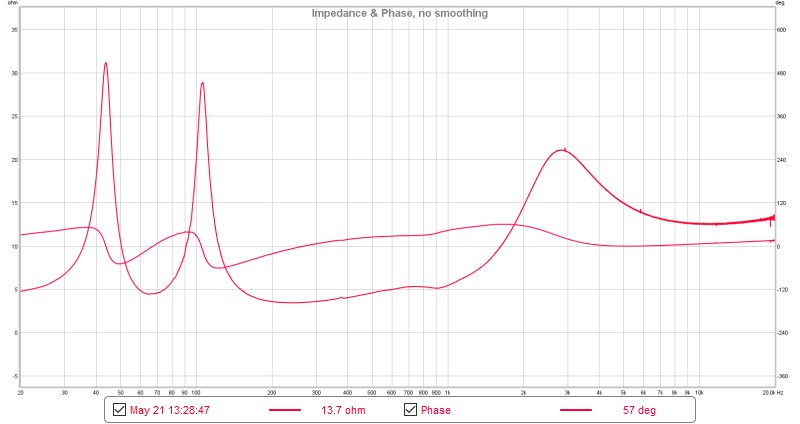

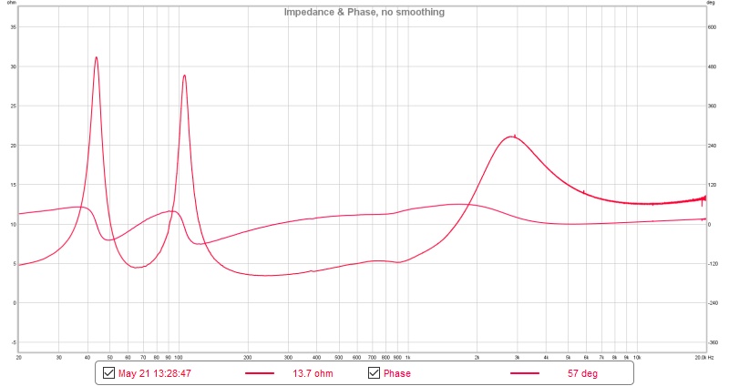

Just brought a pair home to try on my home theater...
Since you asked, here are the impedance and phase measurements:
Verdinut
Verdinut
Pretty nice indeed! Those are good curves and we don't find some as good on several expensive products. Klipsch have the know how!
Those speakers are rather easy on an amplifier.

Actually realized it looked even better than when I measured! Was zooming to make nice fit and did not watch those scales....
Still not bad, but this is more comparable to typical measurement postings...

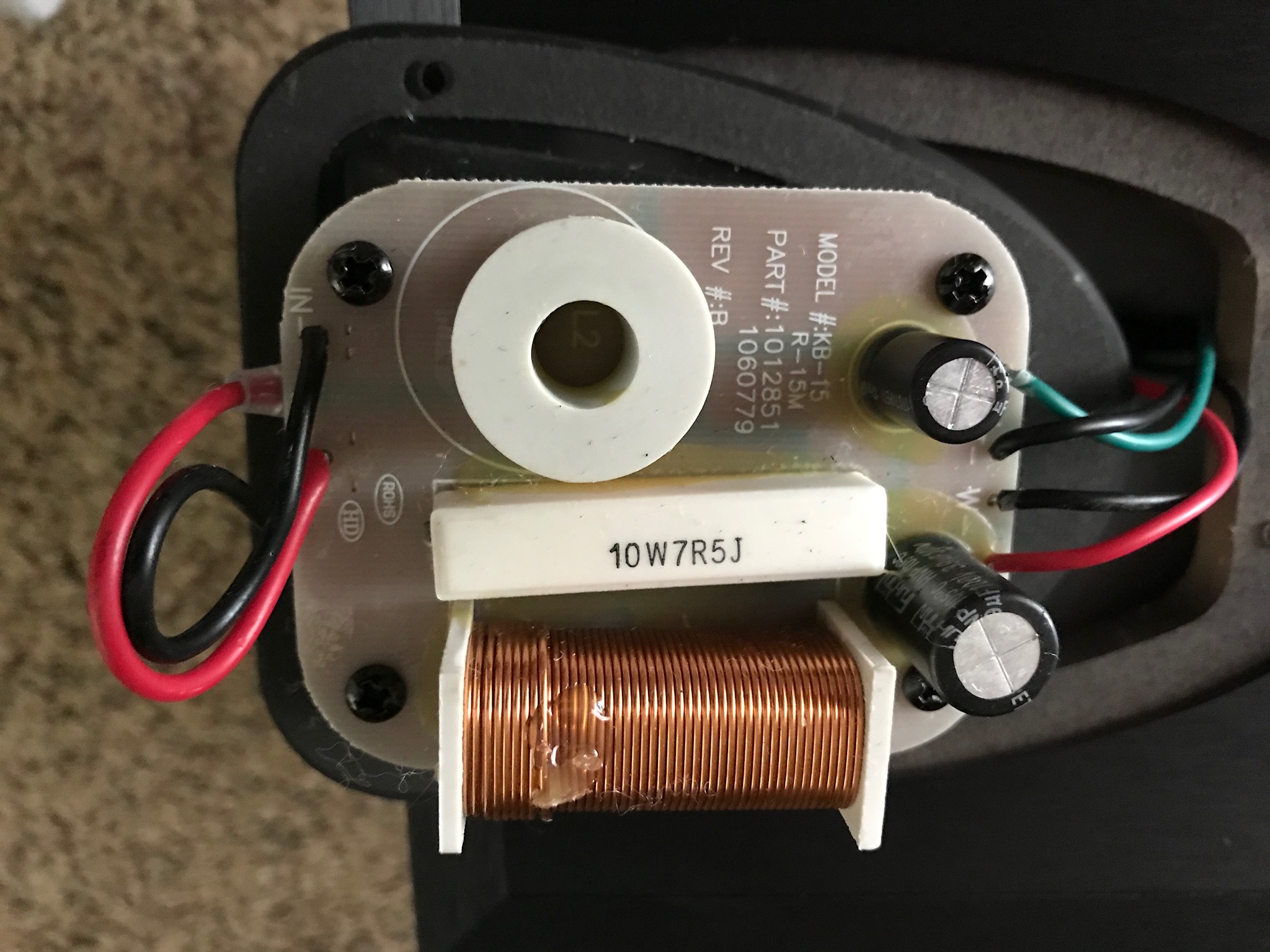

My wife (Winkle is her nickname) came down with stomach flu this morning and asked that I shut down the listening tests.
So I gave me a chance to do the impedance measure and take them apart a bit. The cabinet is not bad with thicker MDF than is typical at this price point, but bracing is limited to some cleats. Crossover is about what you expect for an inexpensive speaker (5 components - 2 coils, 2 NPE caps, one resistor),but does have an iron-core inductor on the LP side...
If I keep, will do some more research and see whether can improve...
Ww
If you keep them, it would be good to replace the choke with an air core inductor, and the electrolytic caps with good polypropylene ones. IMO, Solen caps are as good as any on the market.
