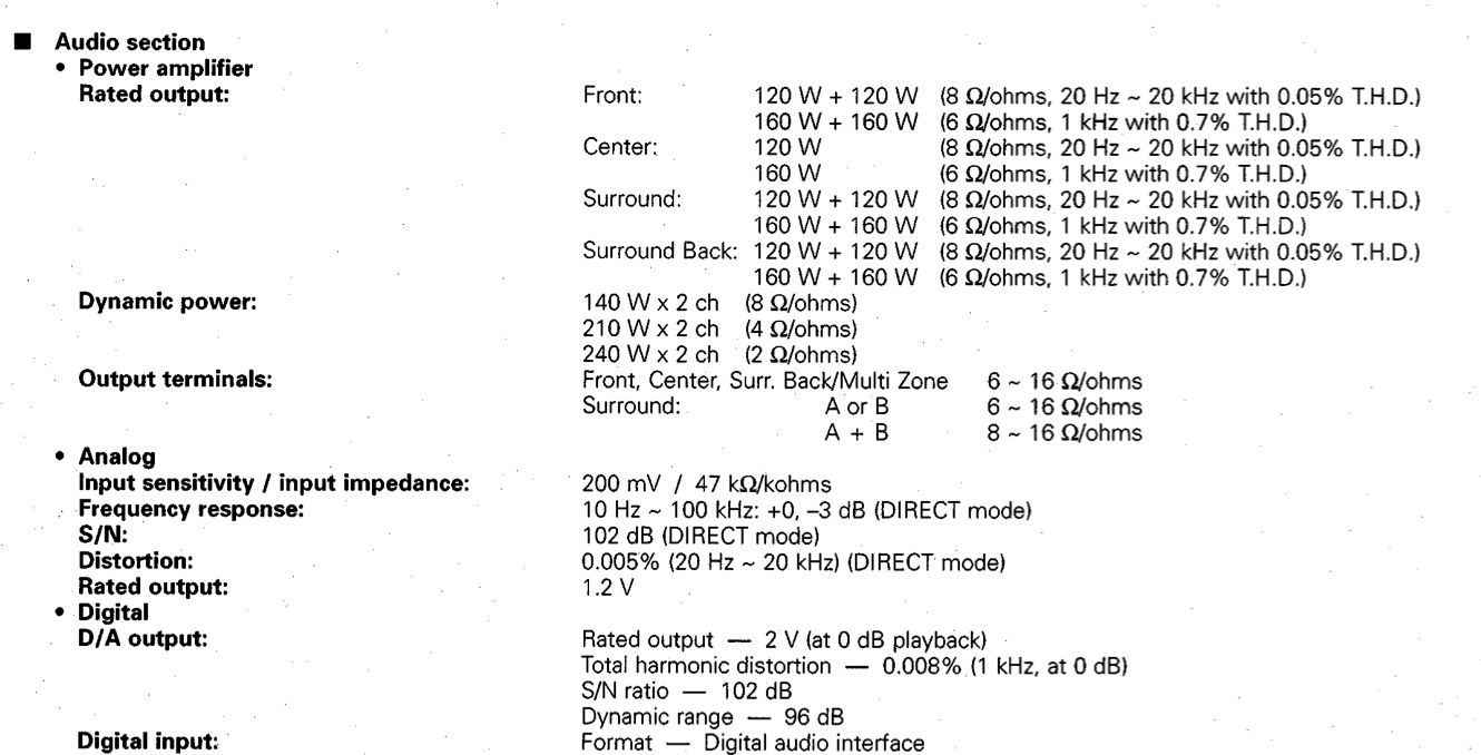

Hello all,
I am just about to cave and buy a pair of KEF LS50s.
They are rated 50-100 Watts power @ 8 ohms.
Is there any harm in powering them with 120watts @ 8ohms?
I already have an amp laying around and wanted to be sure I will not cause any damage by powering them 20 more than what they are rated for.
Thanks,
Mike
How loud will you want at what distance is a better consideration than using speaker max wattage specs which aren't all that useful. Is that a continuous or peak rating? Plus you can also put more power thru an amp than just a particular point on its THD curve chosen for spec....but I would avoid trying to give them that much continuous power in any case, but for peaks likely not an issue, many use amps double or triple the power the speaker's max continuous rating...
mbutir
It is quite an old AV receiver, but quite respectable for its time.
Denon 3805
I am not too sure if the 120 watts is peak or continues.
What are you thoughts on using this as an amp?
I am using the speakers at my computer desk - so I will be sitting 1-2ft from each speaker.

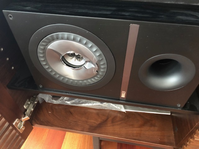

Beave knows his stuff, but he probably has not seen some of the 3805's bench test results.
Multiple bench tests in the past showed the AVR-3805 is as powerful as many two channel real power amplifiers rated 100-120 W 8 ohms, or about 150 W 4 ohms continuous (so called).
It was one of the very few AVR and power amps that passed AVTech's 1 ohm torture test. It has more than enough juice to power the LS50. Even in practice I happen to know this because I have done it. Attached photo is blurry, but you probably can recognize the 3805's gigantic remote.
Report (milleraudioresearch.com)
Just scroll down to see the 1 ohm test. So just relax and enjoy!
