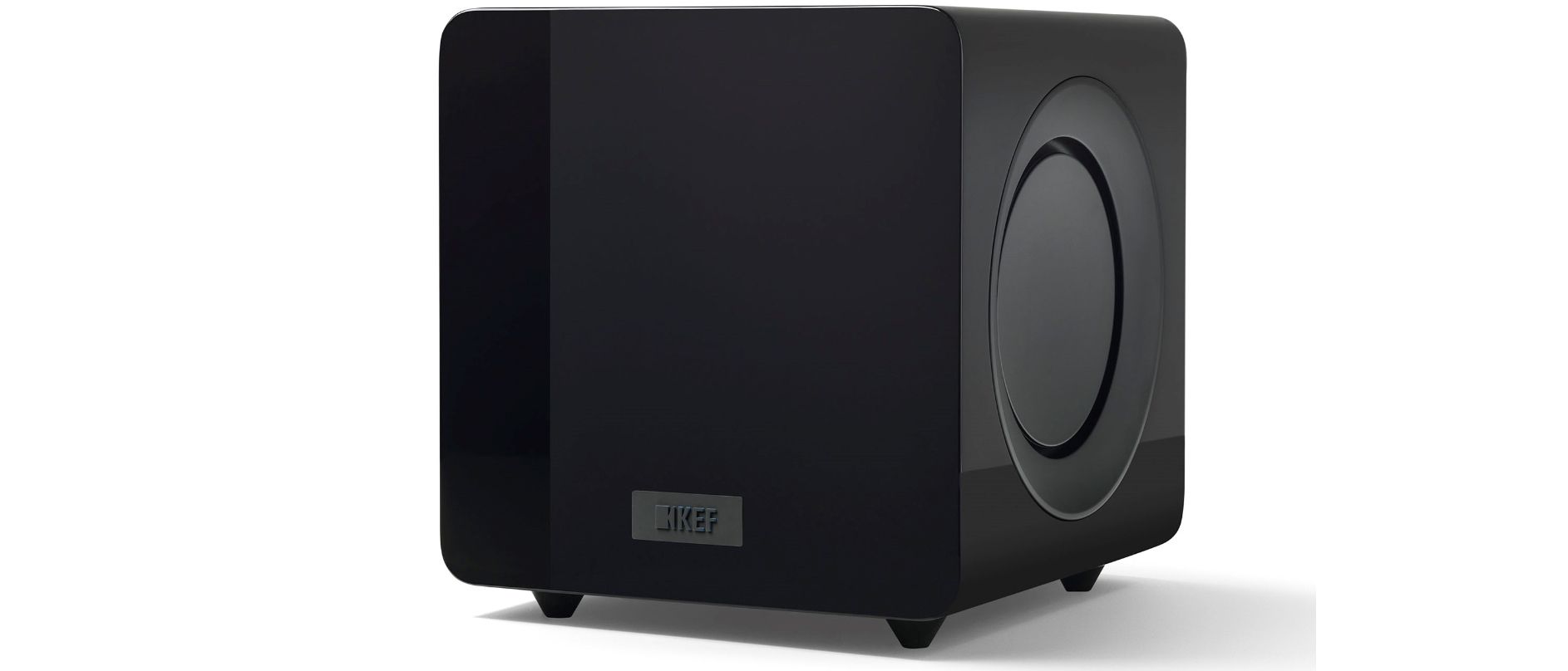

Two drivers instead of one. As I understand two drivers can achieve a higher (SPL) output from the same box (but it's never literally two folds).
How about evening the response across the room? Any benefit there, when having two drivers? Synchronizing the drivers properly allow them to dig deeper with less distortion, right?
Is it easier or harder to achieve seamless integration with this type of sub? It is closed box, but it states it goes incredibly deep (11Hz at -3dB and a maximum of 110dB???).
The driver is what is expensive parts-wise, so it makes sense that 2 driver sub is significantly more expensive than single, would you say KEF KF92 is bordering overpriced or would you say the price is right? It would be nice to have a test of this model.
Has anyone heard this sub? What are your opinions on performance?

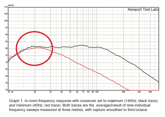

edited to add a review (I know, it's whathifi!) with frequency measurements, which states f3 is 14 Hz, which is still mighty impressive for 2 9" drivers:
https://www.whathifi.com/us/reviews/kef-kf92

I don't have some deep respect of What Hi-Fi reviews, but this time with graphs, I'm linking it for pros here to decide are the numbers really bloated?

Although that one graph was very interesting and would support a very low low-end spec from this sub. Even if it's not 11, let it be 18, it is still very good for a 2x9".

Most of the things members mentioned here, they seem to approached... I've linked a review that even has some measurements (a rarity for modern day What Hi-Fi), you could at least scroll down to graph and see if they make sense.

The measurements done at What Hi-Fi aren’t complete enough for me to say a whole lot. The sub appears to be nice and linear; obviously the anechoic measurements don’t show anything close to -3db at 11Hz, but that’s just as well considering it’s just be a waste of amp power here. Out of the box extension / roll off is good, though how well it can maintain that at higher output levels with respect to distortion and compression isn’t shown. From what data there is, it doesn’t appear to be an irredeemable crapbox, but whether it’s worth the asking price vs say a SVS SB3000 is another story.

A heck!!! Now I have to admit to myself I don't know how to read a graph!!!
I was sure this meant that there is a lot of audible activity below 20Hz and that the roll-off is not steep:

But anechoic looks even better.
I mean, more SPL - 95-96dB arround 20Hz and 17-18Hz is still at 93dB.

Unfortunately there’s at least one key detail missing to put those numbers into perspective: distance.
