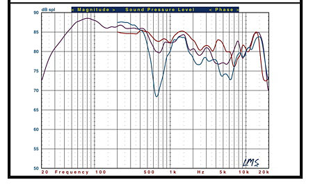

Looking at the frequency response of the OM28 I can understand why you prefer Stereo, because Audyssey would have at least attempted to dial down the mid bass to the lower mid range bands.
Fig.2: Mirage OMD-28 pseudo-anechoic response at 15 degrees above (red) and 15 degrees below (blue) the tweeter.
Read more at https://www.soundandvision.com/content/mirage-omd-28-surround-speaker-system-measurements#2dvCk0RzZGoudVCa.99
It is the speakers that are responsible for the dullness, not the amplifiers. Audyssey default to reference, you should try "Audyssey flat", that should brighten things up a little. The pioneer's REQ system used with different speakers in a different room is not a valid reference/comparison.
