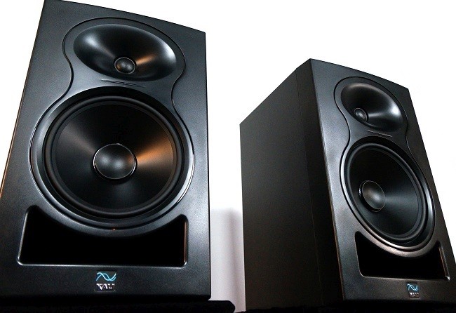

Reviewing the Kali Audio LP-8 studio monitor might seem slightly unusual for regular readers of Audioholics. We are a home-audio focused site and do not normally deal in pro audio gear. However, studio monitors often find their way into home use with the prevalence of ‘bedroom studios’ where people have made a room in their home into a recording or mixing space. The performance demands of studio monitors and home audio speakers have a lot in common; they are both sound reproduction tools that, one would hope, strive for accurate reproduction of the source content. Whether that content is an album or a movie or a work-in-progress shouldn’t really change the behavior of the loudspeaker; it should be blind to content. This being the case, a monitor should be as adept for recreational home audio listening as conventional home audio loudspeakers. One of the things we will be looking at is how these monitors fare for that purpose as well as monitoring purposes. Read our full review to see our thoughts on the Kali Audio LP-8.
