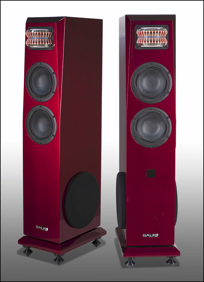

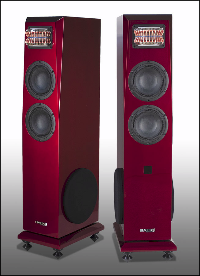

Please note that the speakers Jim Salk built do have active crossovers and internal amplifiers. I don't know the make or model number.
The speaker on the right has a small black square below the woofers. It's an IR receiver for remote volume control and input switching.

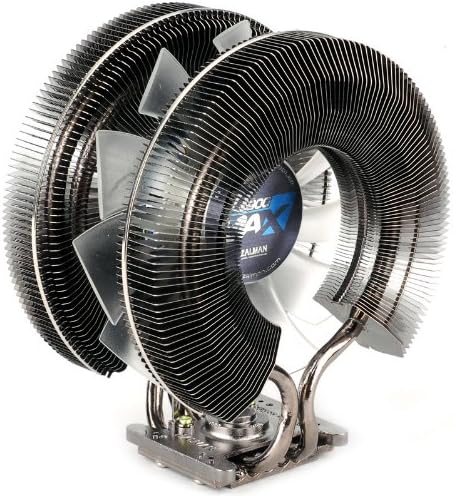

Man, nice looking CPU coolers used as tweeters :)
And, to think that an IR receiver could have fit between the L and K on the name plaque.... If a universal remote system is used, the IR receiver doesn't even need to be on the front- they could have a 3.5mm IR input jack on the rear and never need to deal with lighting causing problems.
