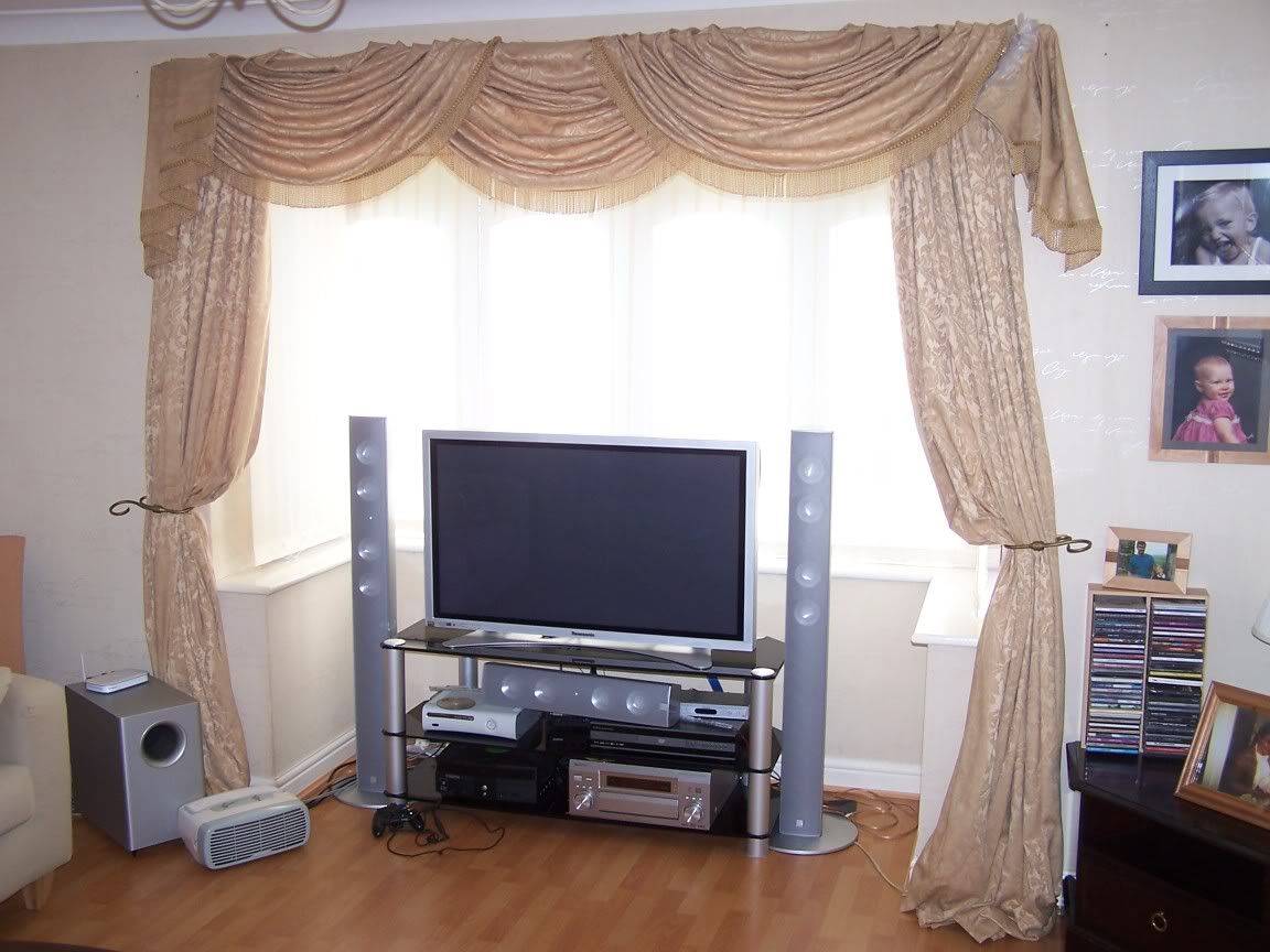

I have taken some pictures of my front room were I plan to setup the HD72i.
Just to give you more of a idea. and hopefull you will not spot any probelms.
1. This is a front view of were I would like to put my screen.. I am selling my plasma to my dad to make room for the HD72. I plan on moving the curtains a little higher and the fancy curtains at the side I will tighten up and move them over more.
http://i24.photobucket.com/albums/c27/jamieuk23/fullfront.jpg
2. Ok this is were we will be sitting.
Height of the ceiling = 8 feet
http://i24.photobucket.com/albums/c27/jamieuk23/sittingarea.jpg
3. Picture of the celing were I hope to mount the PJ.. will be moving picture of the wall etc.
http://i24.photobucket.com/albums/c27/jamieuk23/PJ.jpg
4. I have roled the front curtians up here.... As you will see there is a another celing underneath the main celing which measures 7 feet. If I was able to fit my screen under here it would give me a extra 2 feet in lengh from my back wall were I want to mount the PJ to the screen. which should let me use a 92" screen rarther than 77" which I will dout have to use if I put it directly under the curtains.
http://i24.photobucket.com/albums/c27/jamieuk23/curtainsup.jpg
For me to able to use a 92" screen the screen cant go any lower than were the black line is drawn as you will notice were the red is the wall comes out under the window.
http://i24.photobucket.com/albums/c27/jamieuk23/fullfrontpencil.jpg
so what do you think ?? is this possbile ??
If you need me to take any more measurments just let me no.
celing height = 8 feet
celing height were windows are = 7 feet
distance from back seating wall just below the curtains = 11 feet.
Full distance from back wall to windows = 13 feet
thanks for any help !!
