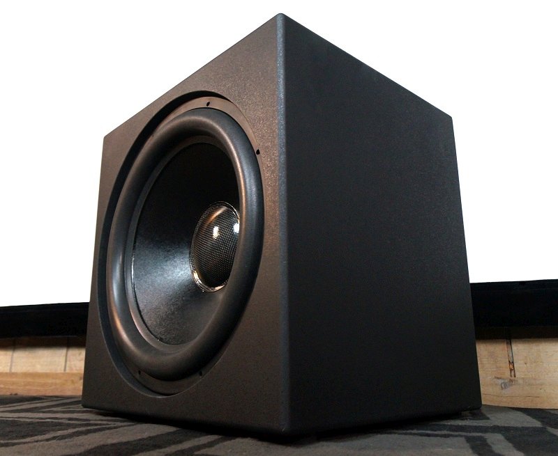

Among home theater enthusiasts, JTR Speakers has carved a name out itself as the go-to subwoofer manufacturer for high-output at ultra-low frequencies. If you want serious bass in the lowest part of the audible frequency spectrum, JTR Speakers is the first name that crops up in any discussion of capable brands. It was that reputation for deep bass performance that made me leap at a chance to review a JTR subwoofer, and in for review today we have the Captivator RS1. The Captivator RS1 is the smallest sub that JTR makes, but that doesn’t mean it is a weakling. With a high-excursion 18” woofer and a 2,400-watt amplifier, this “entry-level” sub from JTR is far more powerful than the flagship subs from most other subwoofer manufacturers. At $2,600, the RS1 is not an inexpensive sub, so what is it doing that commands that kind of price tag? Read our full review to find out!
READ: JTR Captivator RS1 Subwoofer Review
