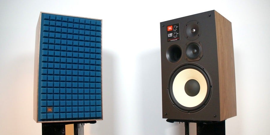

You can't keep a classic down! JBL has relaunched the legendary L100 loudspeaker. It’s not the same exact design, of course, and JBL has modernized the drivers, crossover, and elements of the cabinet, so while it might have a vintage look, it shouldn’t have a vintage sound. The pricing is in line with the original as well, when adjusted for inflation. It’s a tribute to the classic original, in fact, JBL calls this new one the “L100 Classic”. This is the speaker that we are reviewing today. Read our full review of the JBL L100 Classic for a detailed look at what has changed and what has remained the same.

I always have the grills on. I do not care for the eggcrate of the JBL's especially the orange and blue.

Of those JBLs that I have heard with 12" or 15" woofers, I generally like the sound and bass performance that those big drivers offer, but I have never been a fan of those "egg crate" grills. There were too many cheap speakers back in the day that looked like that and for that amount of money I would definitely want a different look. As much as we buy speakers for their sound, the aesthetic can still be a big part of the enjoyment.

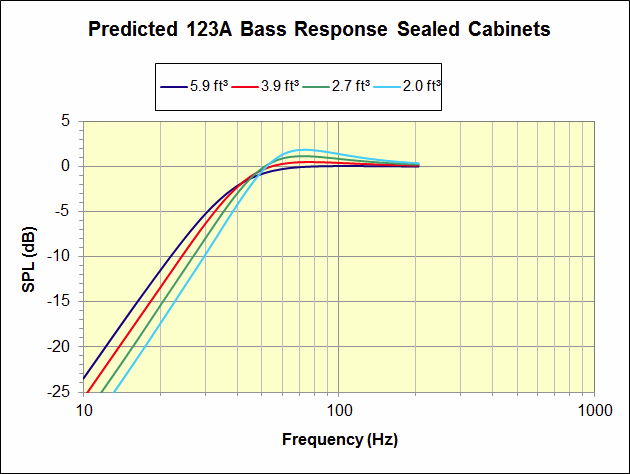

The old L100 speakers had a few problems that even a new crossover could not affect. The JBL 123A 12" woofer was meant for a large sealed cabinet, between 3.9 and 5.9 ft³. (See below) The original L100 cabinet was ported and much smaller, about 1.8 ft³. It's bass performance had a Qts well above 1.0, and it sounded like it. There is an exaggerated peak in the range of 60-80 Hz. It helped sell a lot speakers, but it rang and muddied up the lower mid-range. So, I like the woofer that JBL uses in the L100 Classic. It seems to work much better in that cabinet.

Those foam grilles still attract a lot of attention and comments – not all of them good.
In the early 1970s JBL sold them in three colors: brown, orange, or blue. The polyurethane foam had very large holes, and was brown. The orange and blue versions were spray painted brown foam. I had orange :).
Like all polyurethane foam, mine disintegrated sometime in the late 1980s. At the time, I bought a JBL kit that allowed me to cut away all the foam, and replace it with brown cloth in the same walnut finished frames. Cloth lasts, and polyurethane doesn't unless it has anti-oxidant additives in it.
