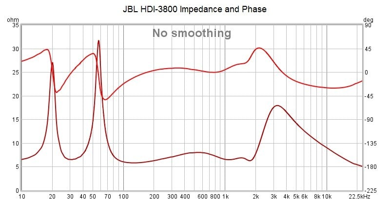

What you need to be certain of is that your Amp is stable for the load:HDI impedance.jpg
The above graph shows the electrical behavior of the HDI-3800. JBL specifies these as a 4-ohm speaker, and that is a conservative rating according to our measurement. If they called it a 6-ohm nominal speaker, I wouldn’t argue. The minima is 5.8 ohms at 127 Hz, but that happens with an agreeable phase angle of 11 degrees. Overall, this is not a difficult electrical load for any competently-engineered amplifier. I think even budget AVRs could cope with this...
From Shady's review here:
So the short of it is yes, you would be fine.
