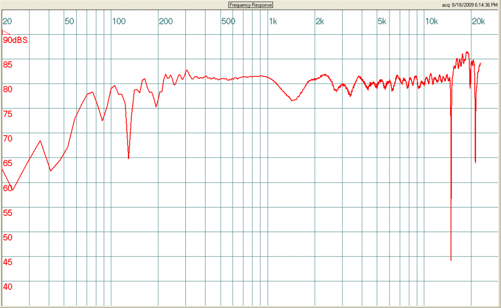

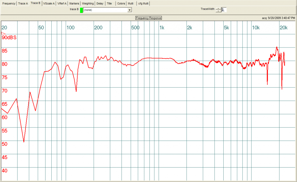

I think the issue is indeed caused by the crossover. Maybe it's JBL's 'thing'. Here is an FR graph of my JBL EC35 before and after being optimized by Dennis Murhpy of Salk/Philharmonic fame. Note the big 6 dB dip around 1600 Hz. (Ignore data below 200 Hz...it's a floor bounce issue.)
Before:
After:
