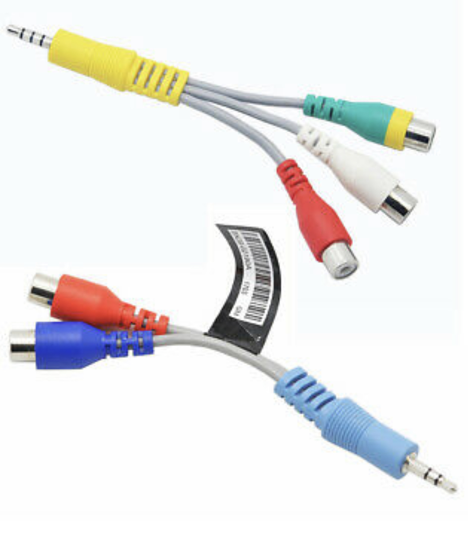

Check the TV settings. Make sure Anynet+ is OFF and make sure UHD Color is OFF for the input connected to the Onkyo. Some older devices will not work well with it ON as it is for devices that support HDMI 2.0. The Onkyo is only HDMI 1.3a. After the change, unplug both of them briefly and fire them back up. If it still acts up, use a composite cable from the Onkyo to the TV. You did keep the break out cables for the TV, didn’t you?;)

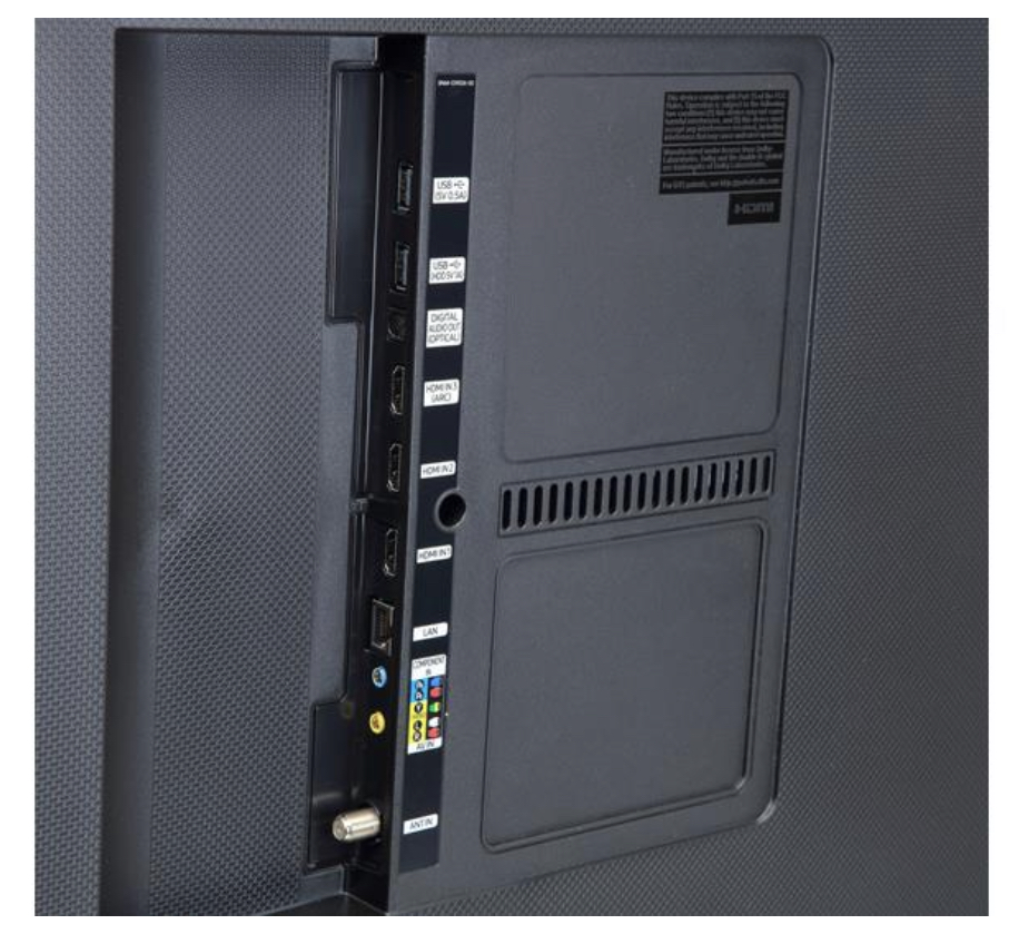

Thought your model might have the breakout connectors. You could do composite or component connection. They would be mini connector ports with yellow and blue colored rings. You would connect the breakout cables to them but seems your TV lacks the ports.:confused:
Indeed; from what I understand (and from what I recall) these Samsungs don't have composite or component hookups any longer...
Looks like just HDMI ports plus the cable/coax hookups (with some USB bullshit or something there for good measure).
