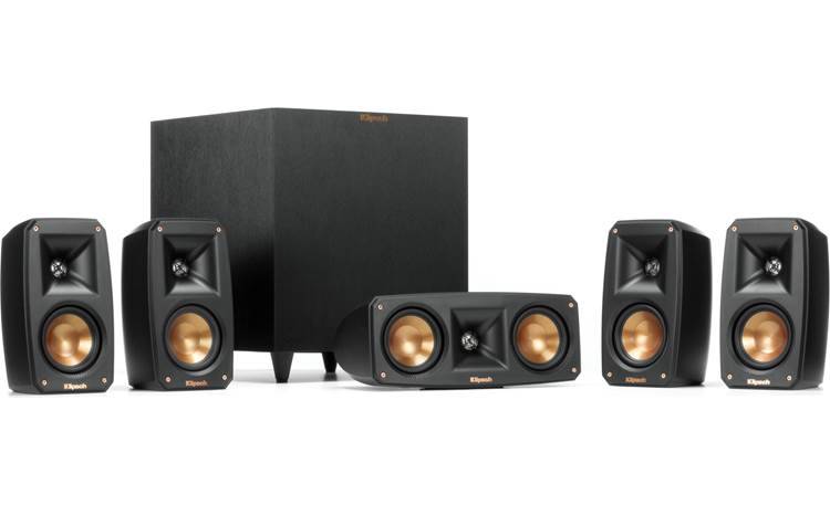

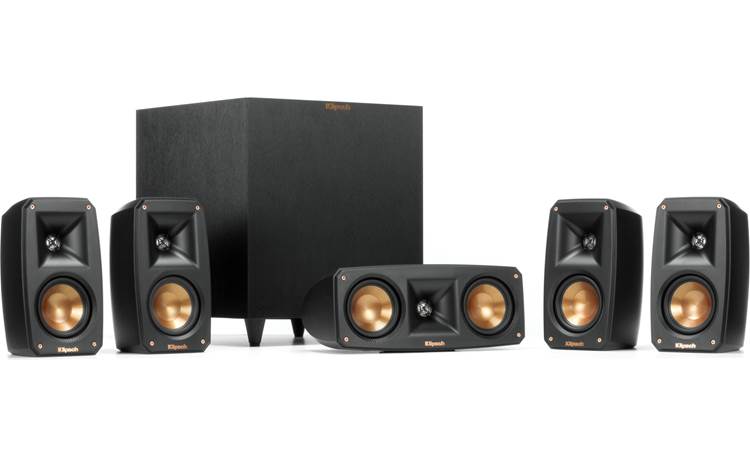

Are you talking about this “Reference Theater Pack?”
If so, how is it you have any extra speakers in what is now a 5.1.2 setup with a 9.1 receiver? Maybe I missed something.

I thought he just added a center and surrounds to his Weberns and thus had two left over.....but I did see sometimes that Klipsch package isn't always a bunch of sats, sometimes includes towers (which can make fine surrounds in any case), so need specific model numbers....and setup :)

I guessed based on the name and referenced specs as the pic is of the “Reference Theater Pack.”

That’s what I was thinking and it makes more sense. If that is indeed the case, I’d use the Webern speakers in another zone since the amps are there.

I assumed they are the Viennas. Technically, the R-625FA package is a 5.1.2 setup.
