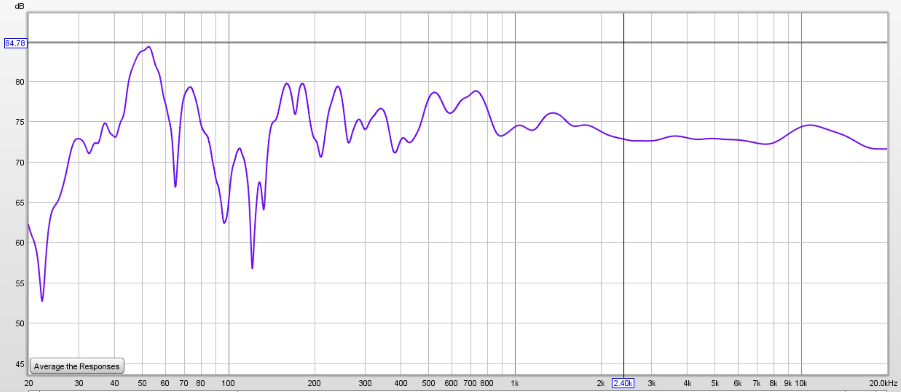

I recently bought a miniDSP UMIK-1 to use in getting my system setup in my new home. I had been using the Audyssey MultEQ app which helps but is very time consuming.
I measured with REW and the UMK-1 , mic at MLP, 90 degree calibration file, three measurements averaged with Var smoothing. Connected to a Denon receiver via HDMI, receiver in Direct mode

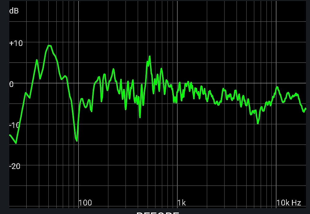

The results in the high frequency measurements between Audyseey and REW seem very different. For example Audyssey shows a massive dip at about 6.5k hz where REW shows a very flat response through the highs.
Am I missing something?
Could the Audyssey mic be so far off in calibration?
See attached graphs.
You also used the same three measurement positions for Audyssey? Are the scales/smoothing the same? I wouldn't read too much into the graph the avr provides....a measurement mic and REW should be more accurate in any case....
paulgyro
Yes same three positions. The practical effect is that Audy makes the speakers too bright which is why this matters. I guess I'll have to take Gene's guidelines and not let Audy do full range correction. Or perhaps try a different Audy mic.
Why aren't you using all the mic positions for Audyssey? I think that's pretty basic for best results. i use first at my primary spot, then the rest in a circle about 2 ft in radius....
paulgyro
I'm trying to find the best speaker and seating positions based on the measurements. Trying to minimize those pesky nulls. Once I find the best spots I'll run all seven positions.
