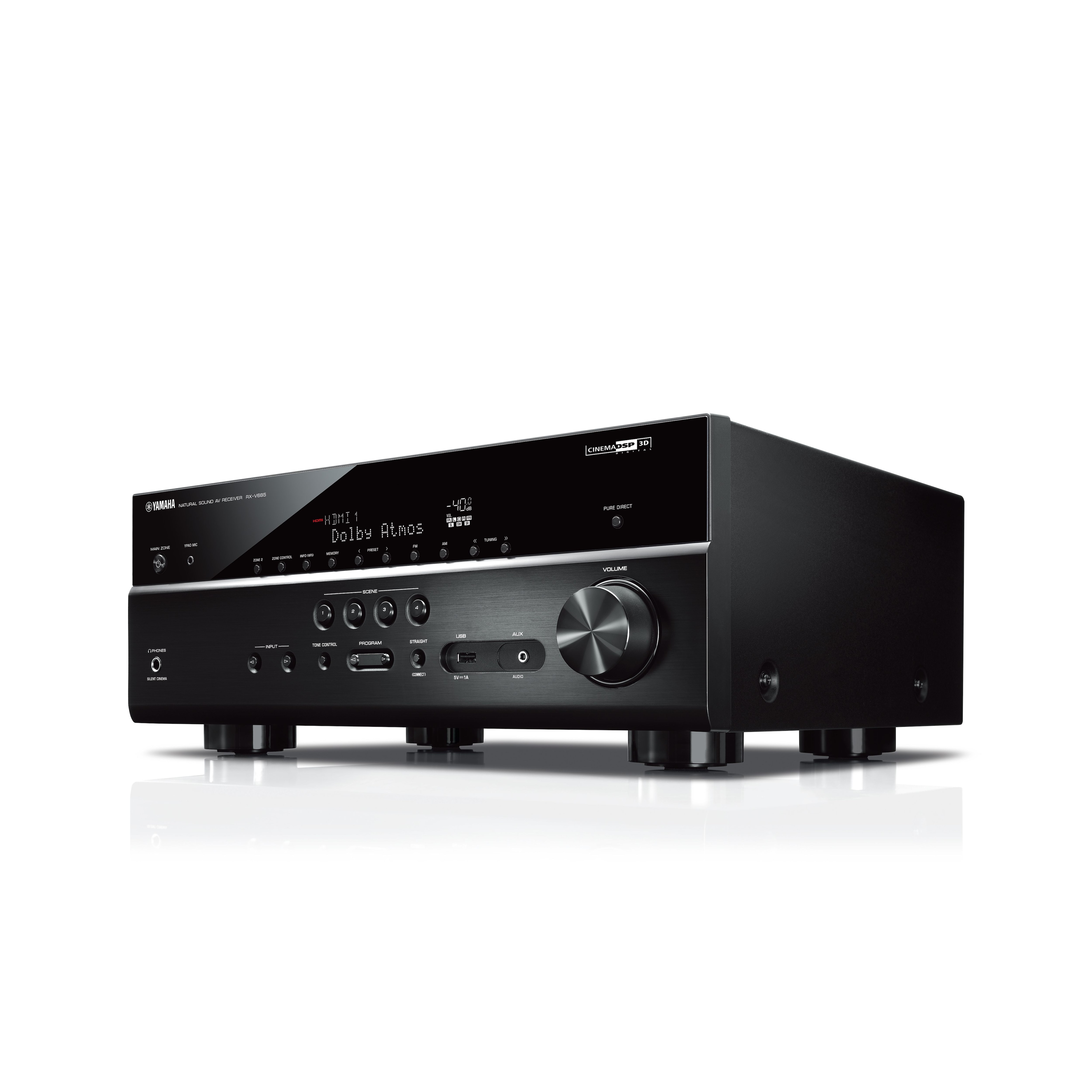

Great insight folks. Thank you! Check out this receiver, if you don’t mind. I know it’s 7.2. Can you just use it for 5.2 and add 2 more surrounds down the road if desired? This is one of the “free” options. Do you think this would get the job done?
