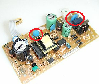

I was hoping for something more straightforward. You know those elements that look like blue M&M’s:
Having one of those detach in my Philips DVD player made the sound look like a poorly picked up radio station. A lot of noise and static. (Disk drawer also failed, so I tossed it, the one I posted pics in AH long time ago) When the same thing happened in one of these old reporters’ VHS Canon’s;
the picture had a lot of static, lost colour and had these stripes over:
You could see the pic but with static. Once reatached, the problems were gone. I was hoping for something like that; knowing from the way they perform if anything's wrong.
It would seem that opening them and testing the XO is the only way to know for sure.
The blue components are called 'disc capacitors'- that type isn't used for crossovers.

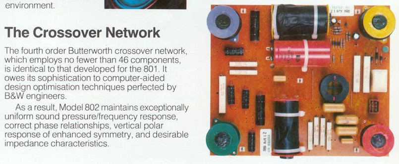

History of B&W says 1987, this is the XO:
I can't tell what they've been exposed to. I suspect they changed a few owners. My father had them on solid 150 but he never liked music loud.

I found some photos of B&W 802 crossovers- may or may not be the same as yours but I'm not sure I would blindly change parts without testing for the before/after response. I might consider changing the blue caps for something "better", but if they sound good, I would probably leave them- the caps are rated for 70WV, which is a lot more power than they're ever likely to see.

The attached photo is from the brochure that TLS Guy sent me, it is the exact model I have. Thanks again.

Might not be a bad idea to check the caps to see if they have drifted but they probably wouldn't use inferior components, so even that might warrant communicating with B&W (or maybe a B&W user group to find out who has done this with good results).
