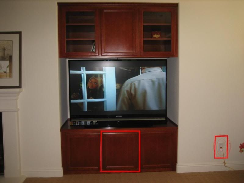

After reading some stuff on this thread.....I had a couple of questions.
1. What exactly does a RF extender do? Below is the picture of my cabinet that I had custom built for my media niche. The cable box is in the bottom center cabinet. RIGHT NOW, I have to leave it open if i want to control the cable box. I haven't bought any speakers yet and on a thread that I had posted asking for help, MDS suggested that I place the center channel speaker in either top or bottom center and put acoustically transparent grill cloth to make it look good. Will the cable box or whatever I put behind the cloth let IR work?
2. Also in the picture above, to the right side, I have a lamp plugged in that has a dimmer. Is there something I can purchase that will control the lights on the ceiling as well as this lamp. I want to be able to turn the lights on/off and control the dimmer througha remote.

1. An RF extender is essentially a wireless repeater. You place them all around the house to extend the coverage area of the RF signal which is good for about 300 feet.
2. IR will not easily (if at all) penetrate wood but it usually works fine thru glass if it is not heavily smoked. IR will go right through grill cloth no problem.
The solution to the issue of having components behind a wood door is an RF remote. You have the remote which transmits either IR or RF or both and you have a base station that accepts RF and converts it to IR.
The better systems have a base station that can act in 2 ways:
- As a 'blaster' where it emits the IR from its front panel. To use the blaster the base station needs to be in line of sight of your components just as an IR remote itself needs line of sight.
- IR emitters. These are wires that are attached to the back of the base station and have an LED on one end that is placed over the IR eye of the component. If the IR signal is very strong you don't even have to place the emitter on the component to control - anywhere in the near vicinity will work (especially inside a cabinet as the IR is trapped and will bounce all around the inside and the ir eye of the component is almost sure to see it).
My preference for IR/RF remote controls is the Home Theater Master. The 'Total Control Series' are both IR and RF and you can program the remote to send either or both. The corresponding base station has programmable emitters as well and you can program the remote and base station to only send certain commands on say emitter 1. Programmable emitters are useful if you have two of the same component or similar components that respond to the same remote codes. The base station can also be programmed to use the blaster, emitters only, or both - very flexible. You would place the base station anywhere on the media cabinet and run the emitters down into the area where the components live. You would then be able to control them pretty much from anywhere in the house and with the wood door closed.
If you have 10 devices or fewer (include your dimmable lights as a component) I would suggest the MX-350. For about $250 (retail), the MX-350 and the MRF-100 base station solves your problem completely. I have an MX-350 but haven't gotten around to getting the RF basestation yet.
