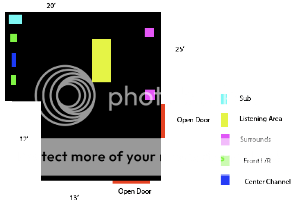

Alright guys, currently my setup is as follows:
Receiver: Onkyo TX-SR674
Sub: SVS PB12-NSD
Front L/R: Klipsch RB61's
Center: Klipsch RC-52
Surrounds: Cheap Bestbuy Speakers (KLH)
Layed out like this:
I just moved into a house with a much larger living room, and I would like to upgrade my system to exceed the requirements of the new room. Currently I'm looking at moving the RB-61s to the rear of the room and replacing them with either RF-82's or RF-63's. I am also looking at a used set of Aerial Acoustics 7B's. I recognize that using any of the previously mentioned speakers would require me to upgrade the center channel as well. My question is this: If I used the RC-52 in conjunction with the 82's, 63's, or 7B's, how bad would it sound? (better or worse than my current setup?) I would like to use my existing center channel while I save up for the matching RC-62/64. Would ceiling mounted RB-61's make good surround speakers? How would the larger floor standing speakers sound in a room of my size run by, and in conjunction with, my current setup?
Thanks,
Craig
C
craigrhyne
Sorry the image is not showing up... apparently I cant post images till I have 5 posts.

The speaker layout seems reasonable.
