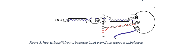

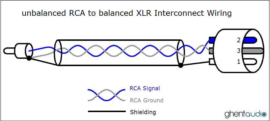

Would I need a converter for the RCA out in the Yamaha aventage 1060 to the xlr inputs of the vtv purifi eigentakt? Something similar to this?: https://www.amazon.com/ART-CLEANBoxPro-2-channel-Unbalanced-Converter/dp/B003S7T49K/ref=asc_df_B003S7T49K/?tag=hyprod-20&linkCode=df0&hvadid=312305907549&hvpos=&hvnetw=g&hvrand=12764942421128172836&hvpone=&hvptwo=&hvqmt=&hvdev=c&hvdvcmdl=&hvlocint=&hvlocphy=9019556&hvtargid=pla-401531180616&psc=1
Thanks again!
PENG

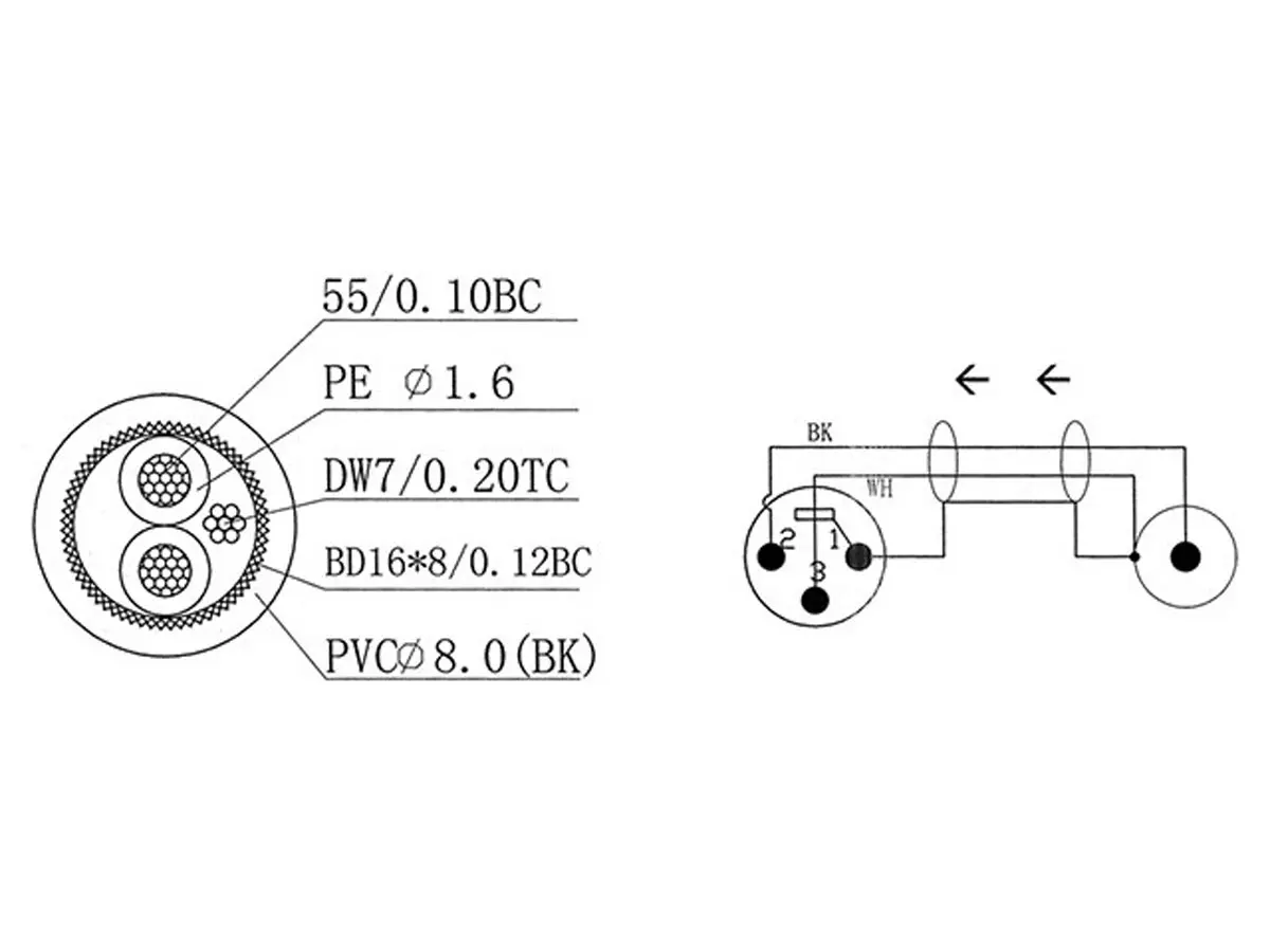

Those boxes may be "clean" for some pro applications and they may not audibly degrade sound quality, but if you look at their specs, they aren't that good at all. Are you sure you need to boost the pre out voltage?

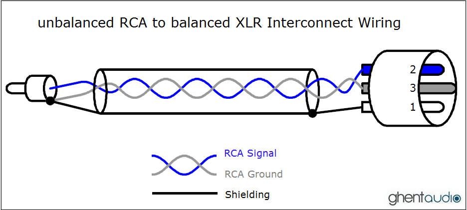

Just grab some of those Monoprice premier RCA to XLR cables, or if you don't mind paying more then buy those from Ghent Audio, March Audio, or Benchmark's though the Mono wires are fine, I tested them on my Purifi amp. They wired the X1 as recommended by Hypex.
ghentaudio --- A15 Canare L-4E6S RCA to XLR Interconnect Audio Cable
Benchmark RCA to XLRM Adapter Cable for Analog Audio - pin 3 to RCA sh - Benchmark Media Systems
Interconnect Cables | March Audio | Australia

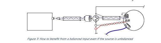

Hypex recommendations:
NC400_04xx (3).pdf
See page 17:

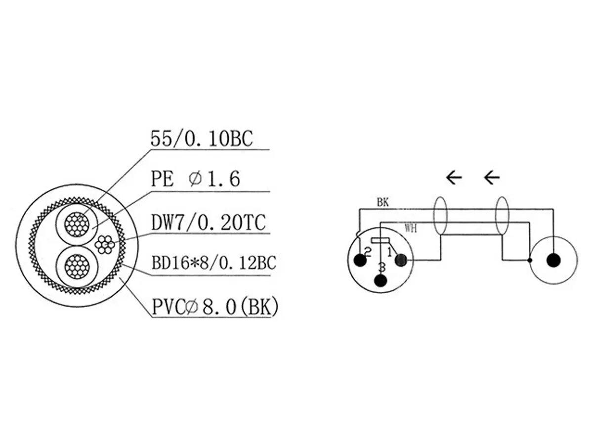

Compare it to Monprice's:
Monoprice 6ft Premier Series XLR Male to RCA Male Cable, 16AWG (Gold Plated) - Monoprice.com
NC400_04xx (3).pdf
See page 17:
Thank you Peng, you have been very kind and helpful. I'll get the rca to xlr cables from ghent or March. I also spoke to Warren from VTV. He said they will work fine. Also, I asked about the voltage difference that others have suggested wouldn't work; he said he hadn't come across or heard from a customer an issue with my line/type of receiver not being able to push the power amp. So, all I need is to save a little!
