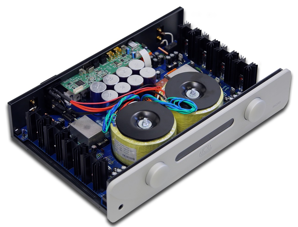

  • Atoll IN200SE (Dual mono design, picture below)
