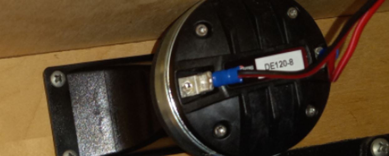

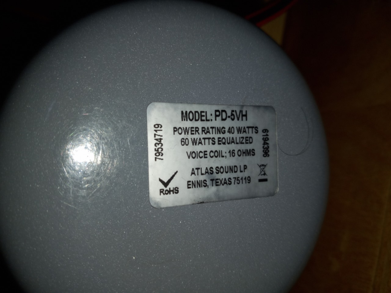

The seller has no clue. He thought just the mid horns were replaced. Turns out that the tweeters are Crites, the xover is the proper Crites model and the mid driver is not Crites but is highly recommended on Klipsch forums as a fantastic driver. 240263395_10222095331904579_5144963576111359560_n.jpg240511717_10222095414426642_1319259335400133406_n.jpg240523950_10222095333864628_7117996585987194581_n.jpg

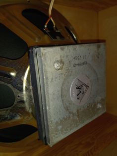

Just got a cover off. Stock Klipsch 18" woofers (I think 18"). I will put the cover back on for now. Then research if aftermarkets will provide more, tighter, better, etc. bass. They sound so fabulous as is. Can anyone tell me if it is possible that that can be improved? Lascala woofer.jpgLS back.jpg

I would not use liquid gasket. You want the speaker to be serviceable. PartsExpress and Meniscus should both carry speaker gasket material. I would check further with the Klipsch forums. If the woofer used a foam surround, then it needs to be checked for foam rot. If it uses a paper surround then just check for tears.
I would not replace the woofer in your case. Any replacement will likely have different specs than the original and that could require redesigning the crossovers again and replacing the crossovers as well. If they sound fabulous now, take the time to enjoy them for a while before researching a woofer upgrade.

I am 99% sure they use paper surrounds, but that is an awesome thing to verify! Thx. If I do nothing, I will at least have to re-seal this properly. I'll check Parts Express like you suggested.

The woofer look to be original, but for some reason yours were not painted.
That midrange replacement looks like a nasty cheap driver. That is not uncommon as a lot of those older horn speakers have developed problems with their diaphragms. Quality replacement are available from sources like Great Plains Audio, but idiots throw the drivers away and bung in any old thing.

The crossover looks to be pretty original with those large Hammond chokes.

The tweeter photo clearly show the Crites part number. And the xover is also a modern Crites. The mid driver is highly recommended by Klipsch folks.

I do not see a good picture of the tweeter.

The Atlas compression driver is not a Hi-Fi product. It's a cheap driver used for PA systems.
Maybe Madisound would be able to suggest a good driver to replace it. However, that could very well necessitate a modification of the crossover components, an impossible task for someone who doesn't have the equipment to test speakers and no knowledge about building passive crossovers.

I know jack about Atlas Sound. But these La Scalas sound great. If I ever had to replace them, I'd go with a Crites product to match my xovers.
