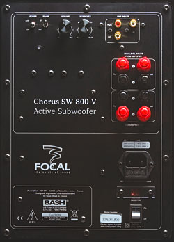

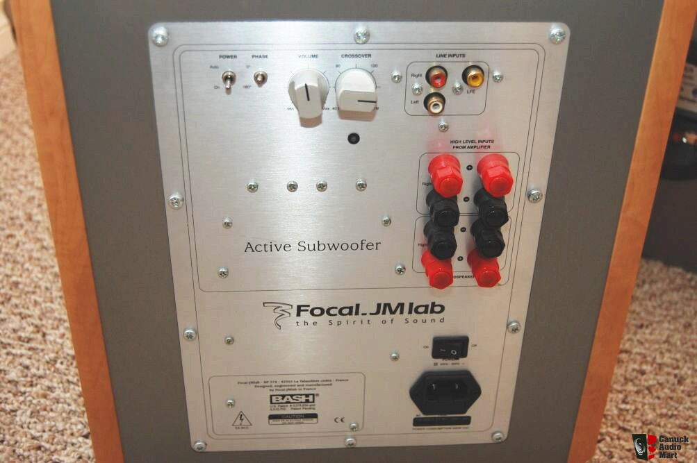

Which model sub do you have? I looked at some, some only had line level inputs but some had speaker level inputs. While not ideal, the speaker level inputs could work to get the sub in use.
It does not have speaker level inputs.
He said it was the Chorus sub and the Chorus does not have speaker level inputs.
Whatever. The Chorus 800 sub does have high level inputs, couldn't find a pic as easily....
