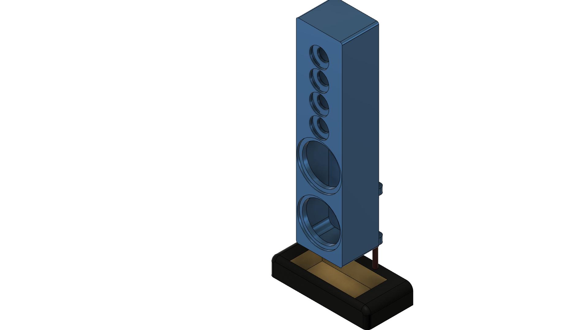

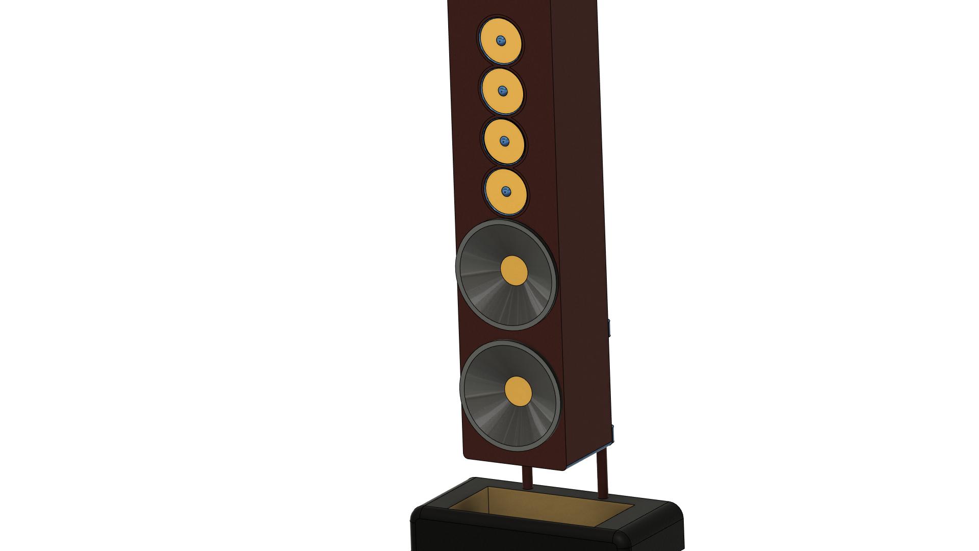

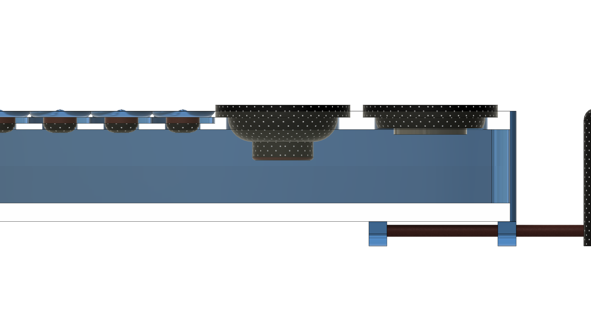

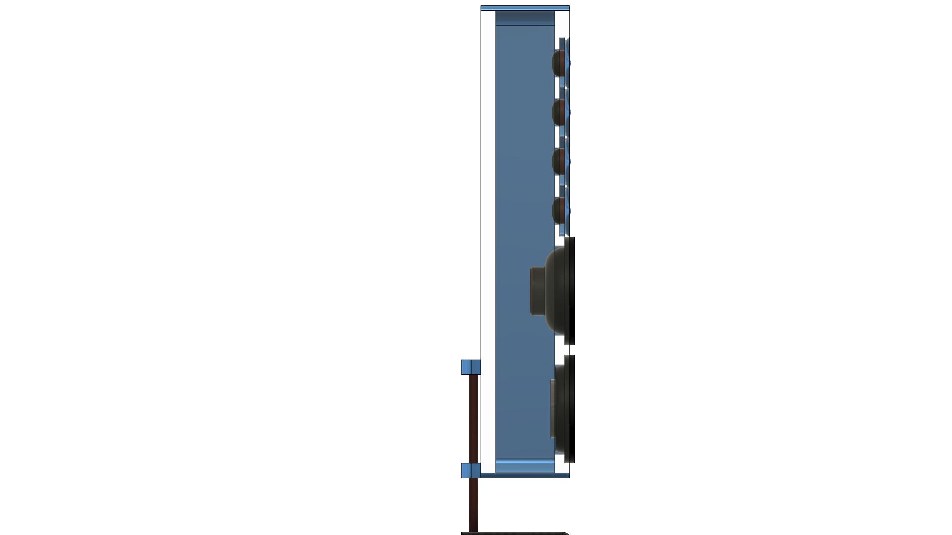

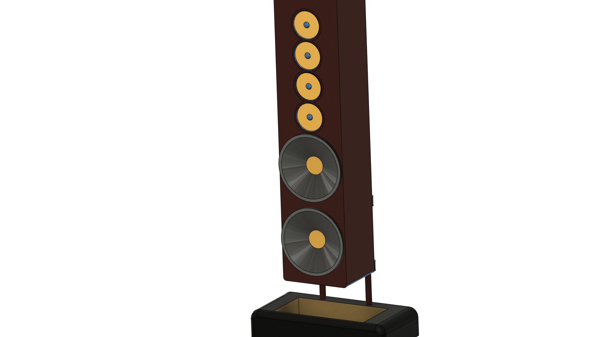

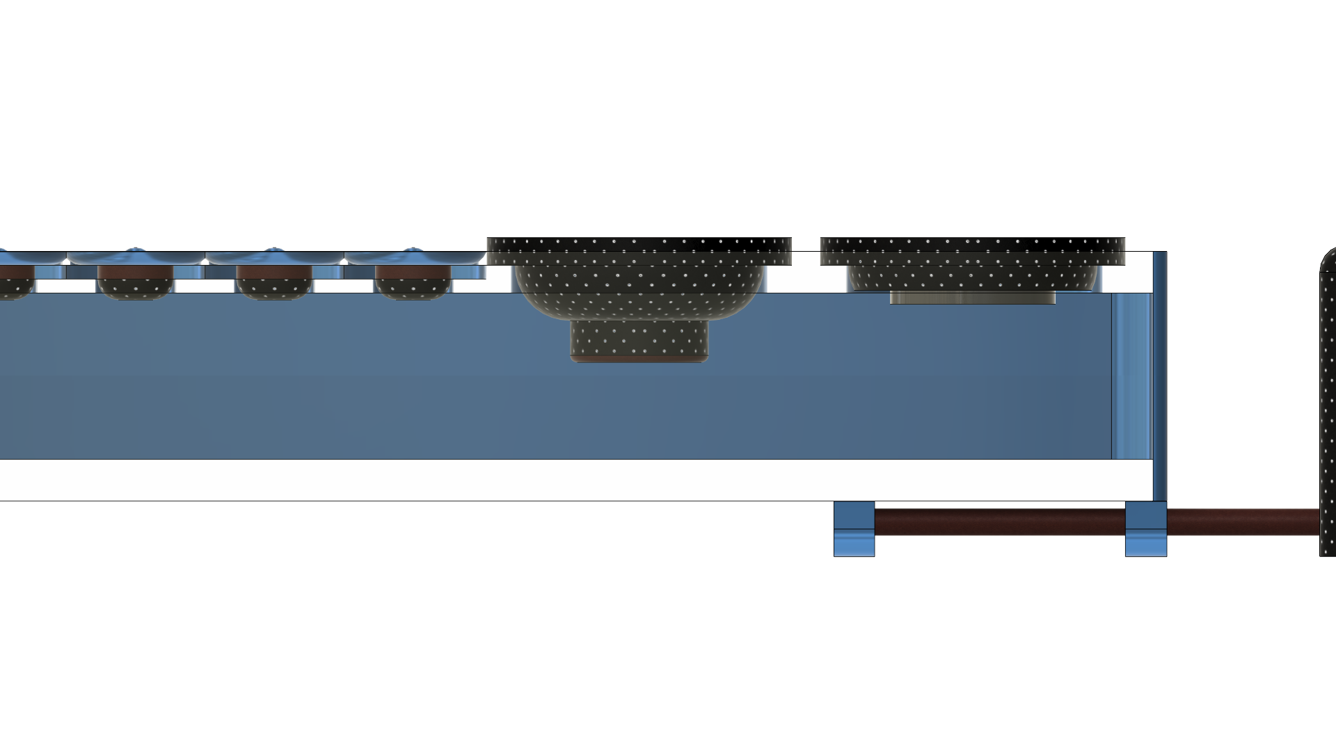

please ignore the color scheme its just what i used in the cad program
the design is to my likeing an i do like the blue a bit
the concept it this
extunal dims are 9in deep 11.25in wide 48in tall
inturnal dims are 6in deep 10.5in wide 47in tall
air space with displacmet factored in is 1.668 ft3
with
one 10in bass driver feed 220watt an one 10in Passive Radiator
with two mids an two tweeters with each feed 40watts
iv got a custom xover being made
with these specs
a 3 way with 300 watts in at 4ohms
xover at 500hz / 3000hz

View attachment 38409View attachment 38410View attachment 38411View attachment 38412
the concept it this
with
with these specs
____________________________________________
the spl read from winisd is at 12ft from the listening postion
my seating area is at 7ft to the center of the room
the lows at 12ft read a peak of 96db at 40hz to a 92db at the xover point
the mids at 12ft read a almost flat of 94db from xover point to point
the highs at 12ft read a almost flat of 94db from xover point to a rolloff at 90db
everthing goes up by 5db
thats pretty good atleast for me
the pink is the lows the blue the mids the greeen the highs

That's big project for sure. If you're designing your own speaker and not from a proven kit, its definitely a good idea to measure your drivers. Even top notch manufacturers have variances.
