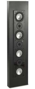

Sure they can sound decent but they will never out perform an in wall system that has been installed correctly For true high performance in walls that sound like mega dollar free standing speakers have a look at these There is absolutely no reason you need to compromise performance if you plan, use the correct equipment and install the system correctly
http://www.rbhsound.com/si6100.shtml
