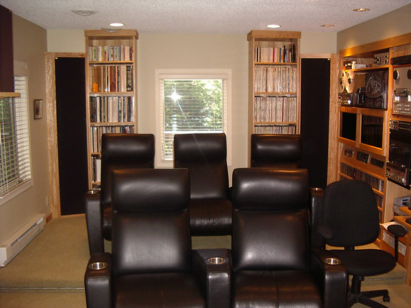

I don't audition in walls, and I do not recommend speakers I have not evaluated. If I do need an in wall then I design and build it.
This center speaker is a through wall.
