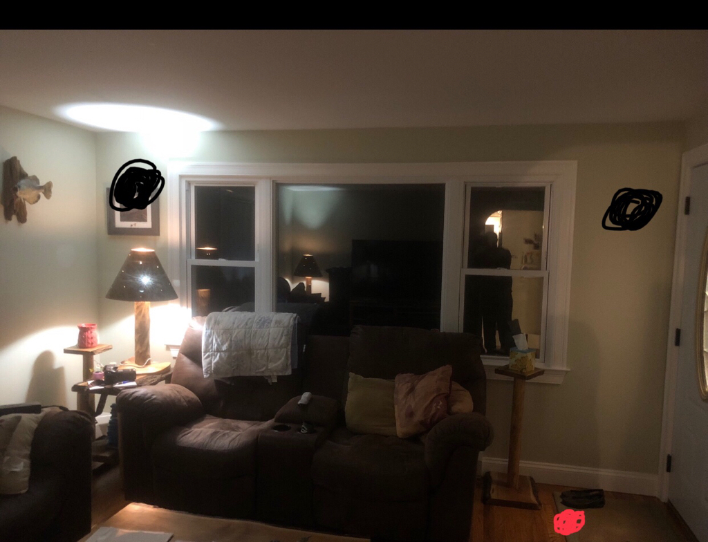

Hello All,
So my speaker build project is officially on hold due to the fact that we just moved half way across the country. I swore whatever house we bought would have a space for me to build a dedicated theater... Well reality set in and we couldn't afford it so I am back to setting it up in our living room. The issue is that the layout of the room is a little odd with storage closets and window placement etc.
So based on the layout there was only one wall that made sense for the television, LCR and the sub. However, the back wall where the primary seating is located is a bit narrow and not ideal for my surrounds. Please see the attached photo.
The room measures 12.5 ft wide and15.5 ft long. As you can see in the photo, the couch is centered and on one side we have the end table which I am told needs to stay. After these two items are in place there is not enough room for my surround speaker stands. The stand closest to the exit door is close enough that if the door were fully opened it would knock into the stand. The stand on the opposite side cannot be properly positioned due to the immovable end table.
So, I have considered wall mounting instead of using stands. On the side opposite the entrance door this is quite possible but on the side closest to the door this is simply not possible without drastically offsetting it. And unfortunately even if I were to wall mount the one side it still wouldnt solve the problem because once the couch was moved the footrest wouldn't open because of the other couch. And in case you were wondering the other couch can't be moved without getting too close to the sub...

Hi JJ. That’s a tough room but not impossible. If that were my room, I might try to wall mount at the(very general) locations I marked in your photo. Use good articulating mounts that would allow you to aim the speakers toward the LP. And yes height is good. Usually between 5-6’ off the floor. Then install a good door stop on the floor. That should keep the door and left rear speaker from making contact. What I can’t tell, is if that would restrict the door swing too much. You could go closer to the window to alleviate that.

Thanks for the response. You are correct though that wall mounting the speaker on the back wall on the exterior door side of the room will definitely restrict the door clearance. Even if we were to mount it close to the window the depth of the speaker would still impede door clearance significantly. This is of course if we didn't replace the speakers with a different model.

JJ thanks for the pic btw. Very helpful. I wish I could stand in the room as that makes things much easier, but...
Anyway, going to the ceiling can be effective, although as you know it will be compromised a little. I assume you’re thinking of being able to have the door swing under the left surround? Sounds like that might be the simplest solution for you. However personally, if it were my room, I would still consider the back wall with a door stop on the floor. Since the corner behind the door is not at 90deg I don’t think that would be a prob.(for me). I would also consider making more of a case for moving the end table slightly forward, and use the speaker stands, although I would still mount a door stop to the floor. In either case the left surround, and door stop could be easily removed if you needed to open the door for whatever reason.
